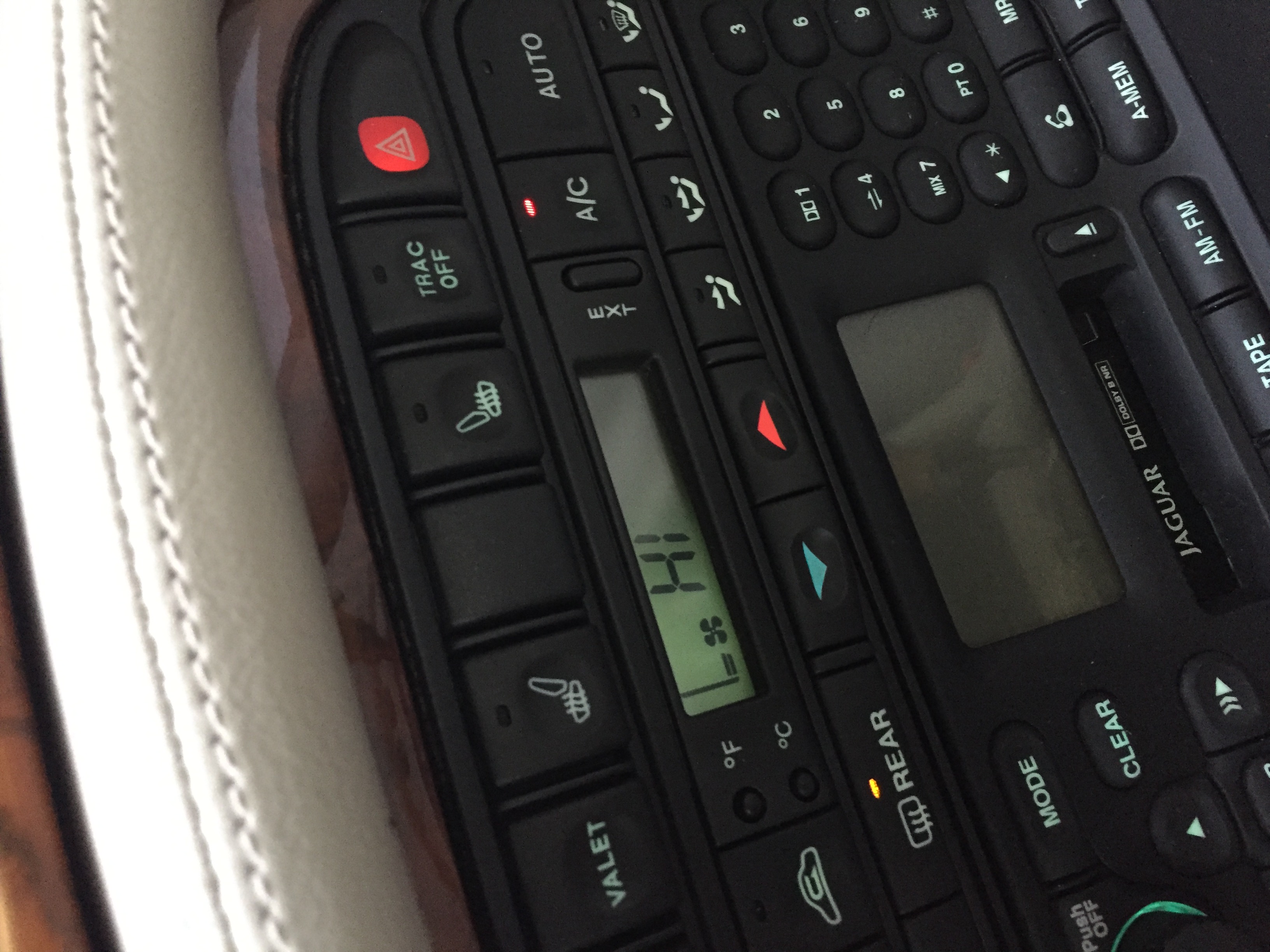

Gents, Fixing of my newly acquired XJR continues and I have noticed that the temperature/ climate control display is only lit up on one side. Does anyone know if this is powered by a bulb or is a LCD display? Picture attached, hopeful I don't have to go looking for a complete unit and this is is an easy fix.

It is just a bulb that needs replacing, they are easy to find on the internet. Part number is JLM11965 and you can buy it from Jaguar for less than £5.
https://www.jaguarclassicparts.com/u...-control-panel
To replace it you will have to dismantle the console area, but it's not that difficult. If you search the forum you'll find the procedure, but you have to remove the j gate surround, ski slope veneer and unscrew the three Philips screws that hold the panel in place. Be aware the panel is plugged into the car via a blue plug at the side of the Gear selection.
