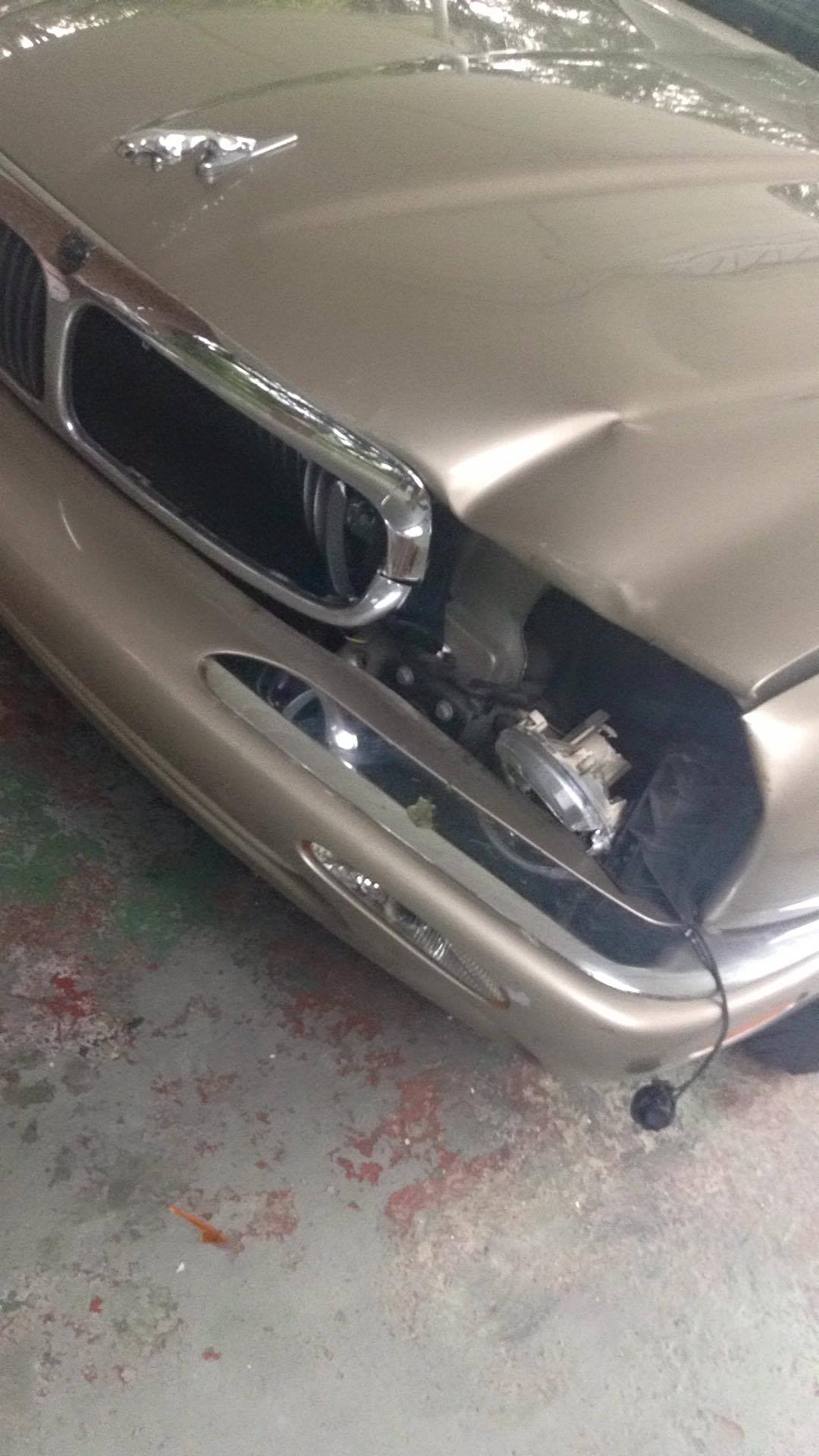

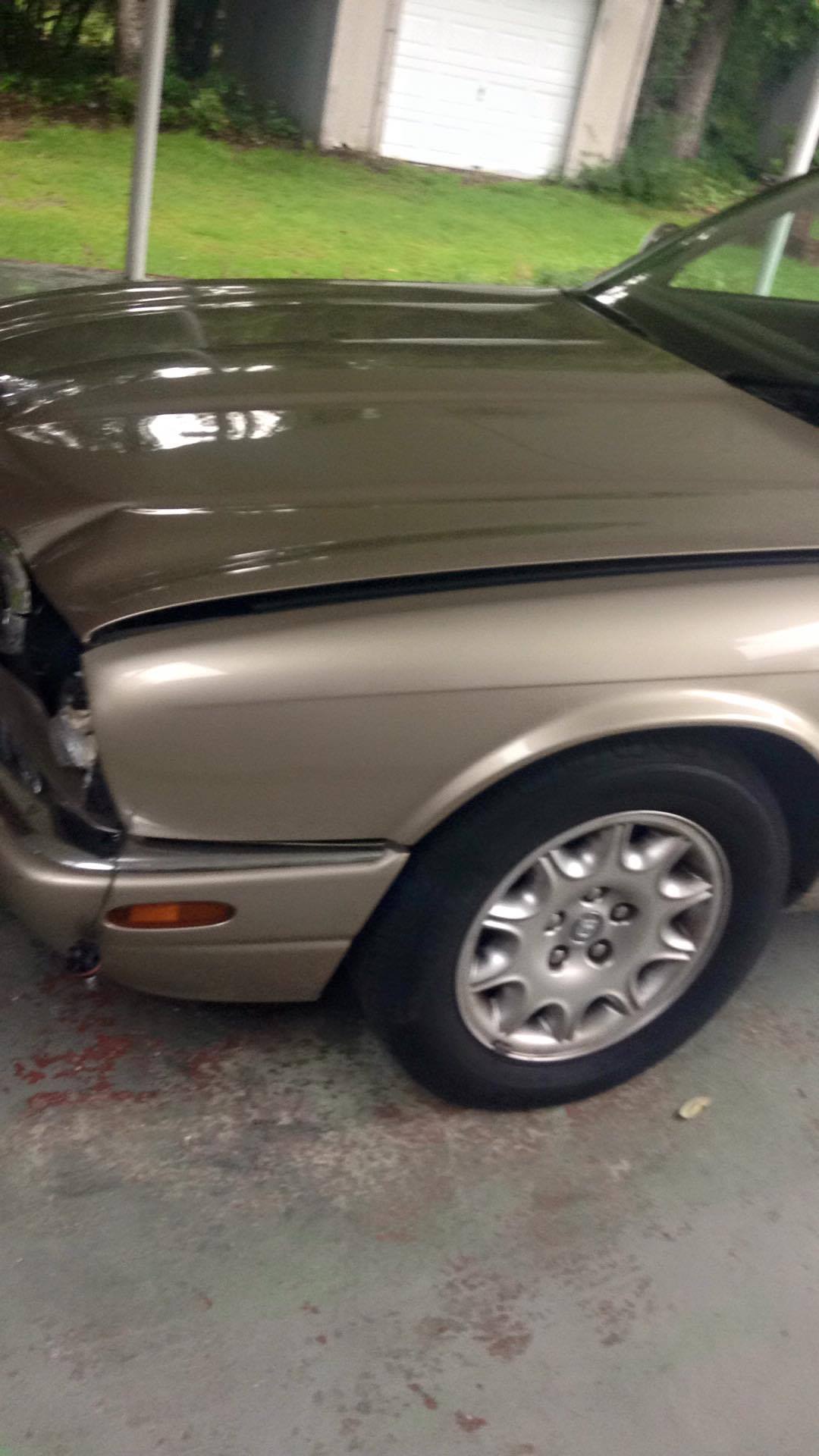

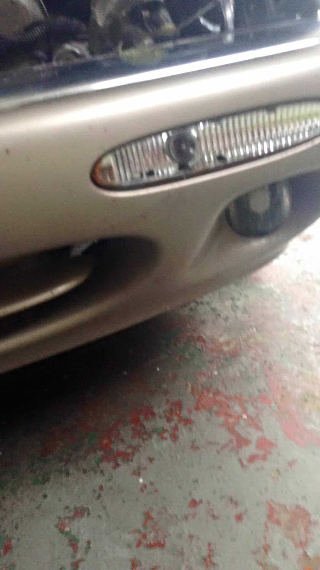

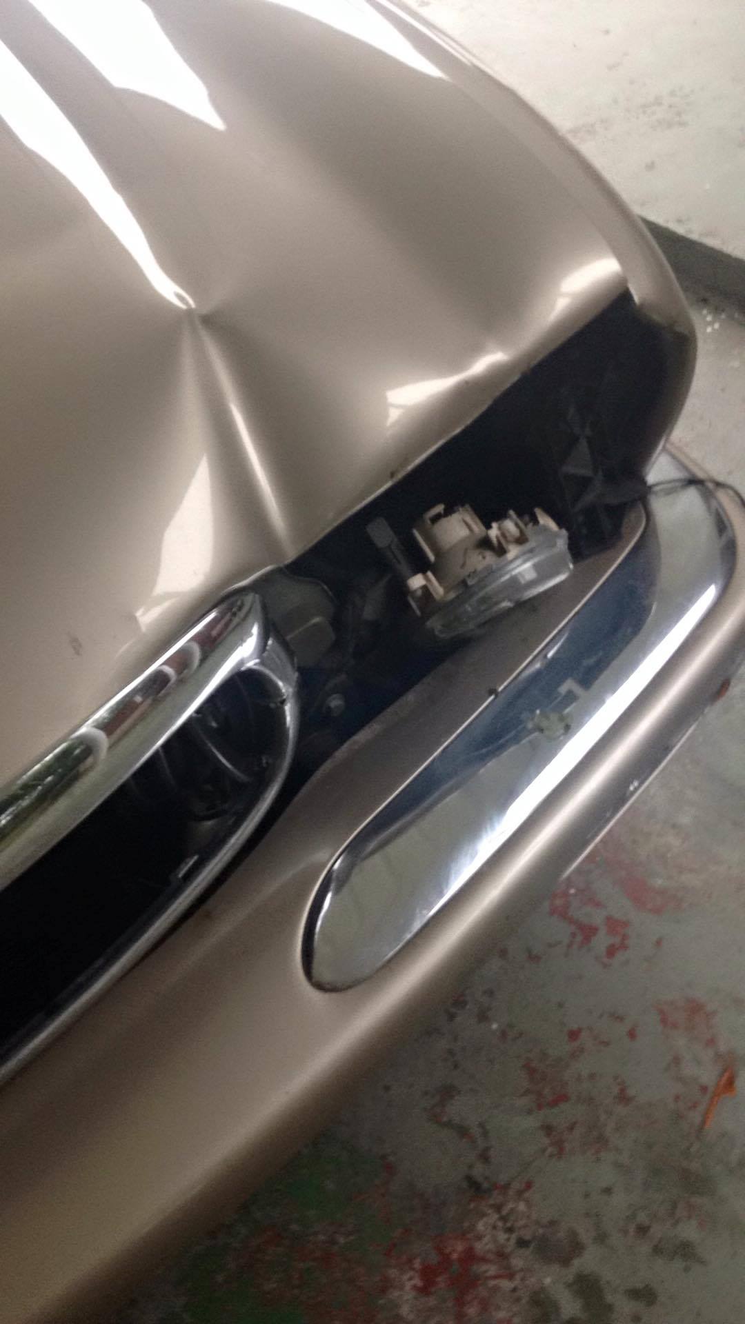

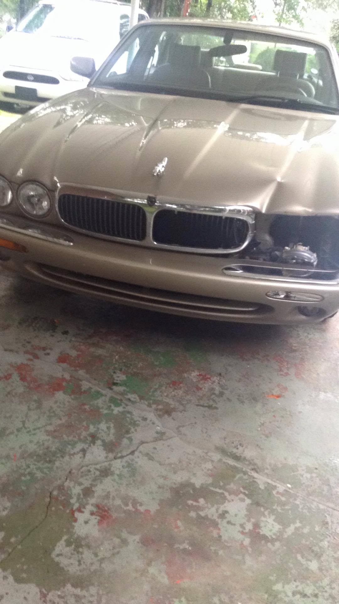

So couple weeks ago I hit a deer In my x308 XJ8. or the deer hit me. (airbags did not deploy) But it smashed into the drivers side front, damaging the grille and the whole headlamp assembly and the turn signal. I was going 50mph and the deer stopped the car. The car runs perfectly just some weird things happened like the i started the car and the car was shaking/vibrating and i revved it and it stalled. and while the car was running it was making a ticking noise while running. (all in cold start). So a body shop estimated $7500 ( with parts ) and I said forget it. I bought the parts off eBay. New turn signal, used headlamps, chrome grille with chrome inserts, and headlamp trim bezel - For $245. I went to a body shop couple days ago and he told me $800 and we made a deal for $700. I'll post some pics of the car before. And after once i received the car from the shop!

Sorry to hear that....
For your stall condition, check your MAF connection to include the hoses up to the connection at the throttle body. Make sure nothing was knocked loose and is sucking air. Check the battery, be sure its sitting proper and hasn't grounded out somehow. Other than that, I would do a reset and see if that clears it up.

I would have your gearbox checked out too if it went to a dead stop from 50mph, a great deal of strain will have been placed upon it and it's associated parts.
When I had an accident in one of my old XJ8's, it wrote the car off, the engine was still running after the crash. I found that impressive.

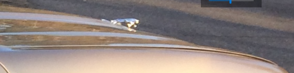

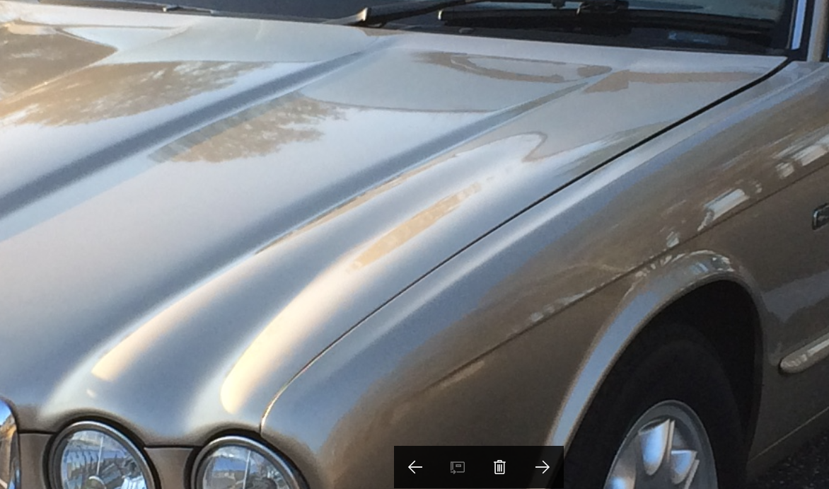

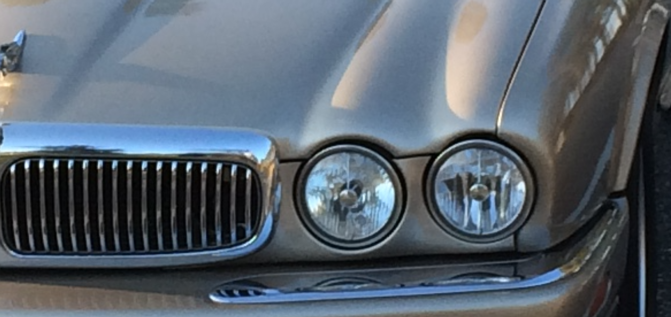

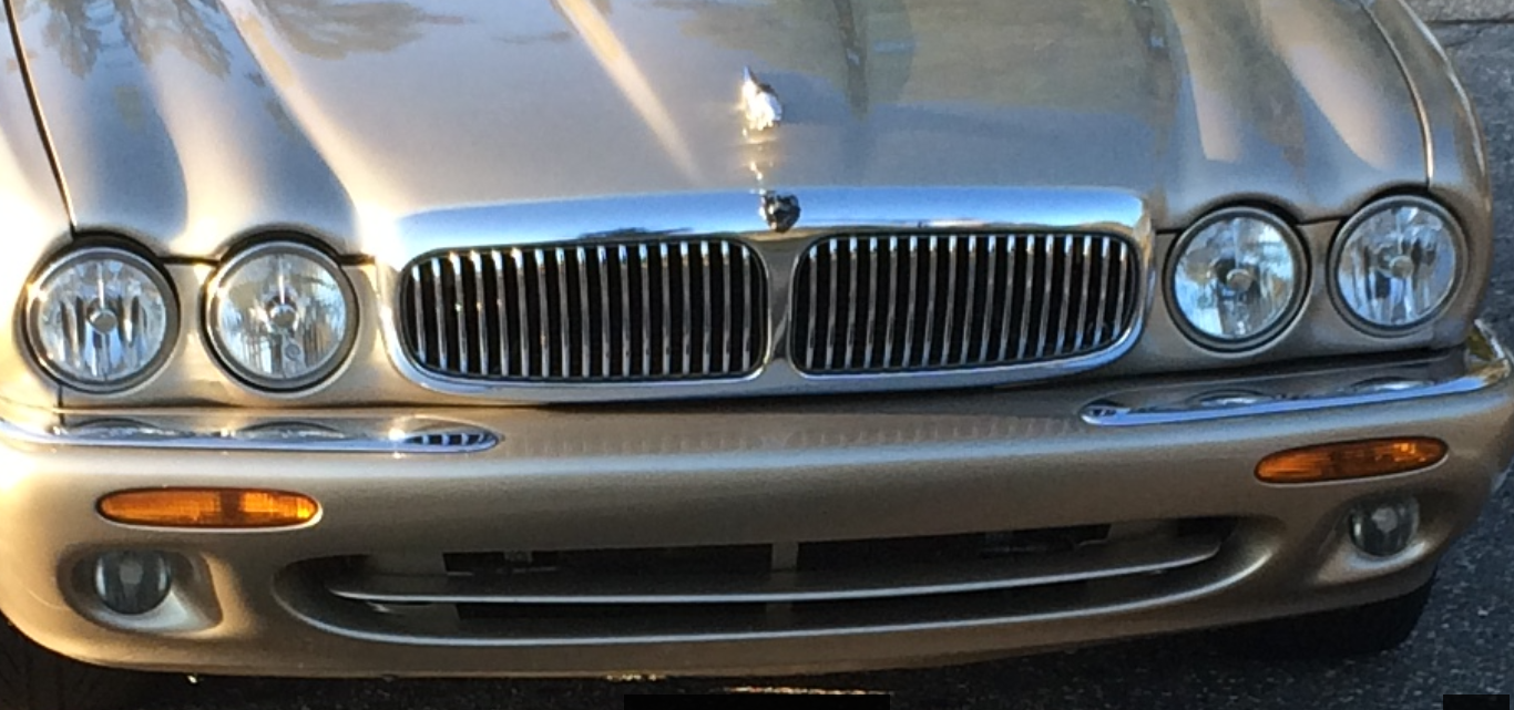

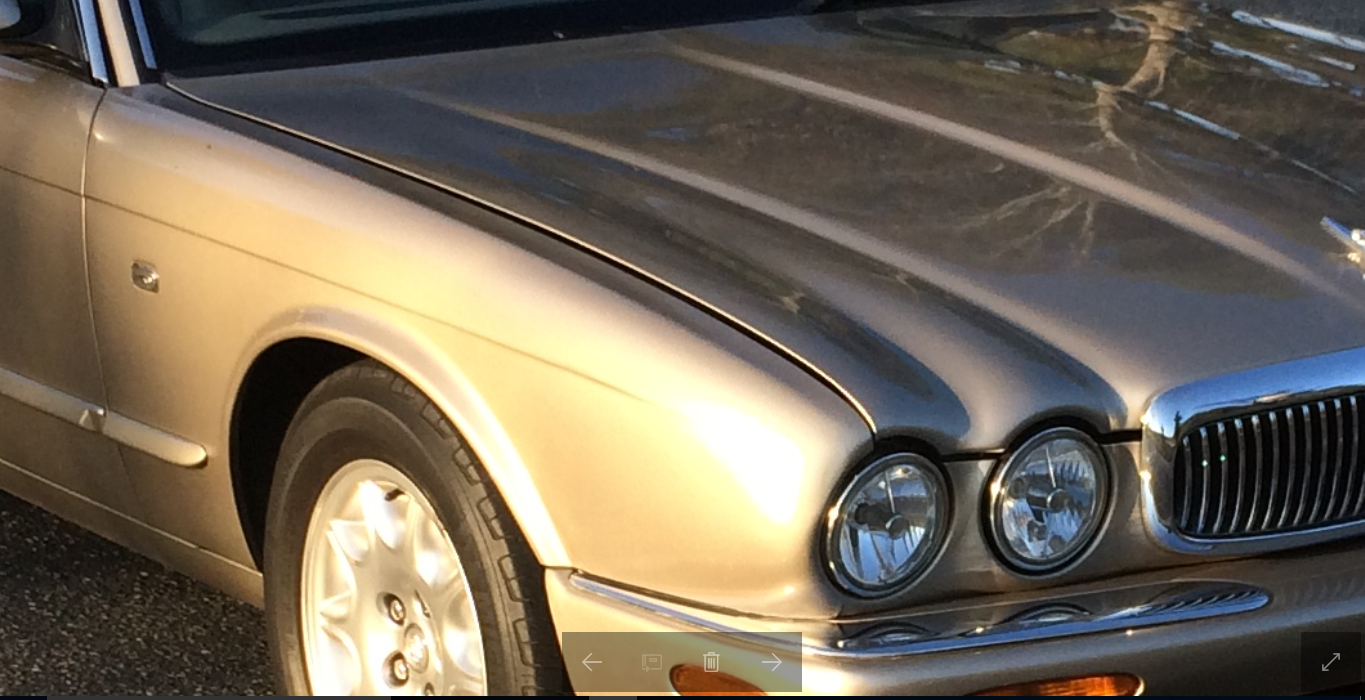

ok so couple month later and now i have hood panel gaps from the body shop that said "thats the best I can do" attitude. Before going to any other body shop is there a way I can go about doing this my self?

Well, first off, did you pay... Mr That's the best I can do, already? If so, I would be asking for about 4 hrs of work back.
For the hood itself, it appears to be shifted to the right about 1/8-3/16". Did they take the fenders off to complete their work? Because the hood looks pinched between them pretty good. The passenger headlights don't look quite right, like their not aligned, yet they shouldn't had been touched, it was the other side?
Didn't you say the hood didn't latch well in your other thread? Until that hood gets moved over, it won't latch well. Offhand I would say the passenger fender looks to be the culprit. Getting it moved will allow the front of the hood to move that way and square it up better all around and allow the pins to seat properly.
You need to get behind that grill and see how its aligned or its fruitless for any of us to contemplate much more of this.
More pics would be valuable, pics from the hinging behind the grill, pics directly in line with the hood/fender alignment, pics of the hinges with the hood up and pics of the fenders (from above as best possible) with the hood up. If you see something else you feel needs a pic of it, do so. No guarantees of fixable responses, but its a start of their so-called finished product.
"Best they can do?" It looks like they didn't even try to align the panels properly.
That is the worst I have ever seen come out of a "professional" body shop.
Correct panel alignment is one of the minimum requirements for a job like this.
No way I would accept that.
These pics and a bit of your time in small claims court would be a definite winner for you, if it goes that far.

I'm having a hard time believing that for $800 the body shop said anything except "we will do the best we can"
To properly fix that damage required a new hood .. and I'm guessing a new fender. Did they paint anything? don't see how $800 gets any painting.

The passenger fender had a huge dent which was fixed close to the headlight. And yes I did pay him.
