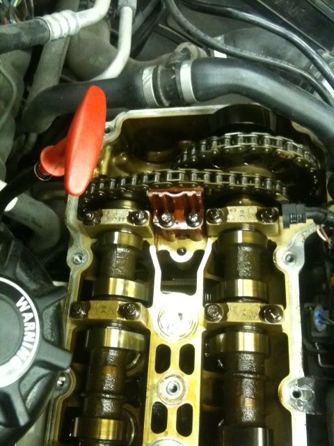

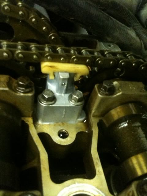

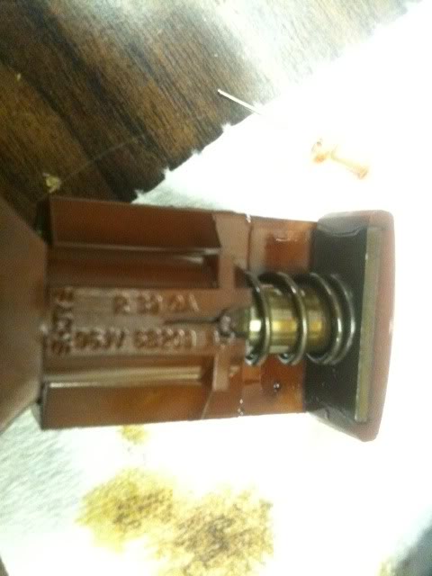

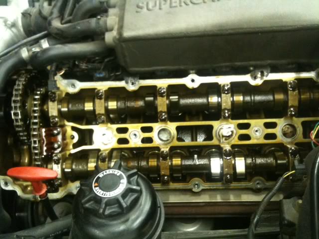

So I did the secondary cam chain tensioners in my buddy's garage last night. It only took 3-3.5 hours! I used the zip tie method. I was careful to relieve pressure on the cam by spinning the motor until none of the exhaust lobes were pushing the valves. This was possible on the right, the left had a little pressure on it when I tightened it back down.
There was a good bit of oil in some of the spark plug holes. My buddy made a quick parts run for me, so we could replace the O-rings too. Does that generally cure this problem?
Anyways, it still makes some chain noise once it's warmed up. I guess it's time to prepare to do the primaries. Ugh.
Here's the pics

Did you use the shorter bolts that the new tensioners require?
If not then oil pressure bleeds out between the tensioner and head where the oil passage runs. That leads to less or no oil pressure for the VVT.

I definitely used the new shorter bolts. Can't you see from the picture? lol
Give me some credit yall, I am a mechanical engineer. Though I'm not sure if buying this thing was the smartest thing I've done. If I can get his problem licked I'll be infinitely happier.
