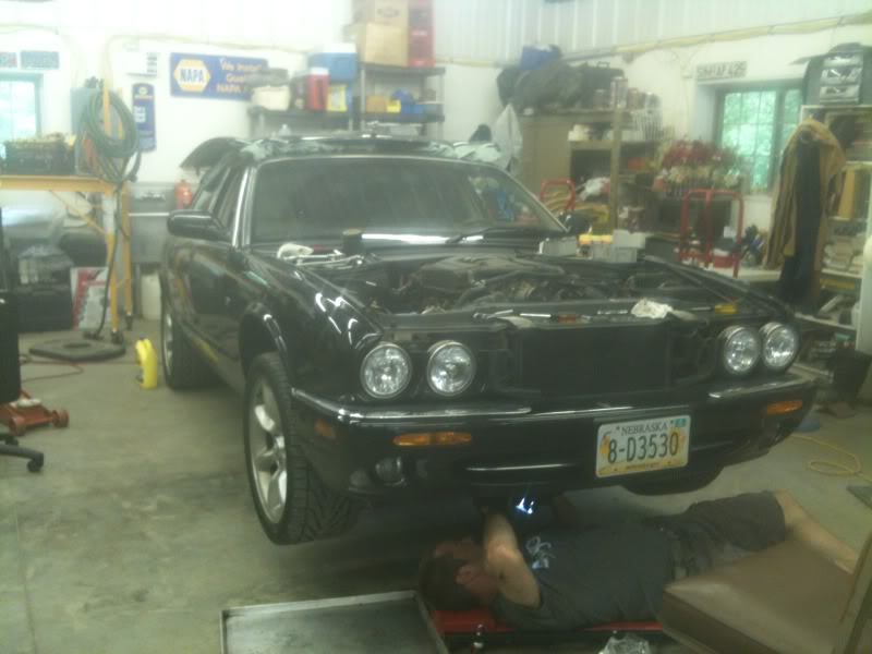

Here's the post primary tensioners and chain replacement vid. Note, it doesn't have the airbox on.
IMG_0486.MOV - YouTube
The rails were cracked in multiple places. Also one of the tensioners didn't pop out when I removed it, and the other did.
Now I've got a leak from the water pump gasket to contend with. The replacement WP I ordered from chris had a metal gasket in the box with it. It got damaged in shipping, so I suspect that's why it's leaking.
Also, I have an oil leak on the drivers side back bottom corner of the valve cover. So I've got to dive back in and resolve that. I replaced it when I did the secondaries earlier, so I'm hoping it's ok. But I might just replace it again.
At least it doesn't sound like a GD diesel anymore! Hallelujah!
