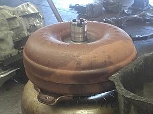

It is at AAMCO right now, whole transmission is getting rebuilt.
It put this crack in the valve body, so that is getting replaced.
First rust that I've seen anywhere on the car...how worried should I be?
