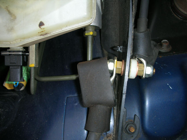

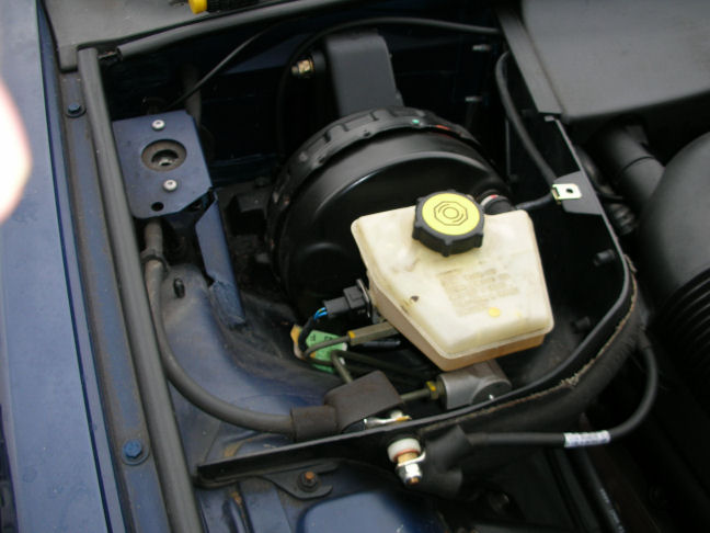

Located the false bulkhead cables, where the brake servo is. I was initially using another picture as reference from the booklet by avt007 kindly uploaded by avern1 which had a large electrical unit near the cables. Anyway, both cable ends read 12.4V (engine off)......
As mentioned earlier I tested the voltage from the engine when running (meter leads on throttle body and shock tower (earth) and there was very little voltage there (16 on the 2000m meter scale whatever that equates to)...
Thanks
AndyP

Old Dec 19, 2015 | 08:41 AM
sparkenzap's Avatar
Joined: Nov 2007
Posts: 4,502
Likes: 1,068
From: atlanta ga
kyle-
"voltage from the engine" where? and "very little voltage there" what is the atecedent to the pronoun "there"
In other words, where the heck are you getting these voltages near zero with the engine running?
It sounds like you have found the problem but lets be sure.
Old Dec 19, 2015 | 08:51 AM
yeldogt's Avatar
Posts: 1,887
Likes: 346
From: NE
You will not get 12v everywhere. Many of the sensors are variable. I would stay away from the T-body -- you don't want to be messing with it.
The connection looks fine -- but I would still open it up and to be sure.
If you are getting 12v at the connector -- and nothing is working ,, including the headlights that don't require a key. This should be easy to trace with the electrical diagram.
