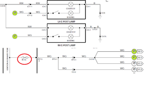

On my last post I am having a problem with interior lights through out the car none of them work. started changing bulbs but getting no ware is there a main fuse or relay that I am missing ????? thanks jrb53

Use the wiring diagram to trace the circuit, or use a volt and ohmmeter to determine if there are power and continuity through the circuit.

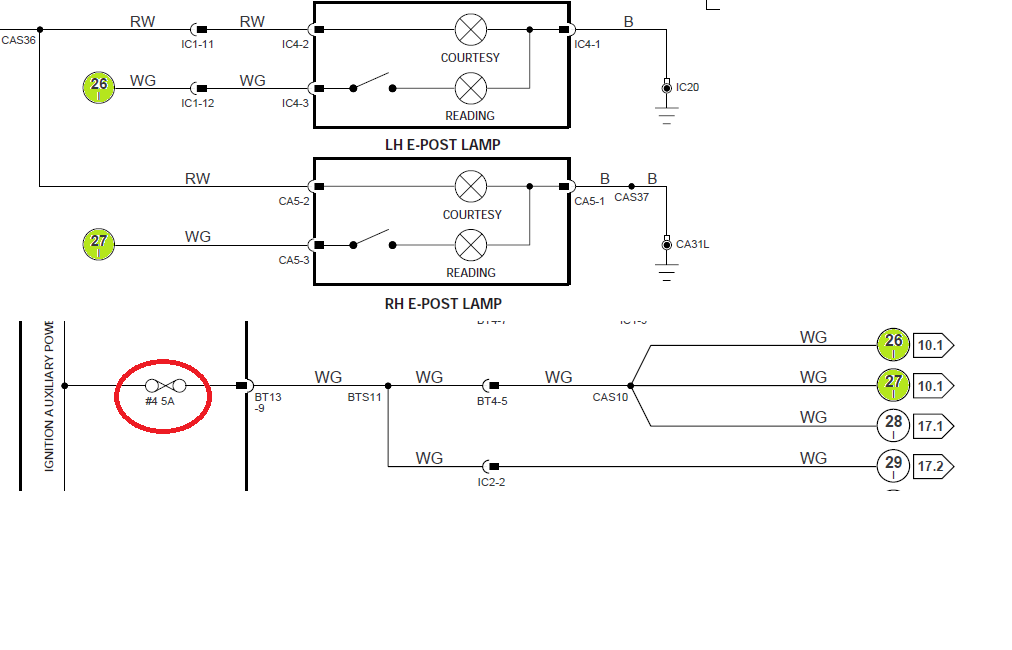

# 4 in the trunk
