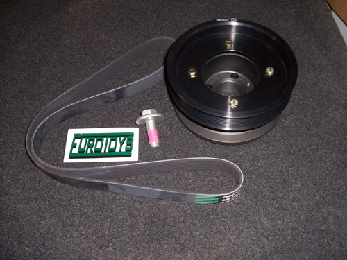

How does this one look?
Originally Posted by avos
On the 4.0 cars, the lower crank pulley has 2 rings, the SC and accessory one, and only the latter is separated with a rubber damper, making it a harmonic balancer. Look at the attached picture they show on ebay, you can clearly see how the ring is sperated with a black rubber.
The SC ring is one part of the pulley unit itself (not separated with rubber, except for the 4.2 cars where it is), and is NOT fixed to the accessory ring.
As said, the one I saw the SC ring was centered (more or less fixed) to the main pulley, nothing wrong with that as long as they would leave it at that.
Problem is they use also 4 bolts to fix it to the accessory ring, making everything rigid, and that’s NOT good. Do a google on harmonic balancers, there is lots written about it.
Old Oct 12, 2012 | 02:34 PM
avos's Avatar
Joined: Apr 2008
Posts: 3,616
Likes: 1,070
From: Europe
Can't tell from the picture, but the 4 bolts seem to be closer to the centre contrary the one from PH, so I would ask ET to be sure.

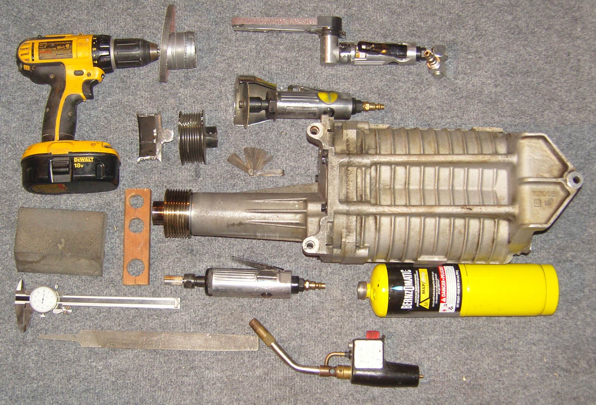

Default Oxy-acetylene not needed to heat the upper pulley
I had a knock sensor fail on my 2000 XKR so I needed to remove the supercharger to replace it. I purchased the 3lb boost upper pulley from powerhouse and with the supercharger off the job of machining the nose was not too bad. The attached photo shows all the tools I used to do the job. I cut a wood piece with a couple holes to used as a guide to rotate the die grinder around the shaft. This really helped keep the cut even. I finished up with a hand file and used the sanding belt and drill to get the final finish. I did not have an Oxy-acetylene torch so I gave it a try with Map gas and a $20 torch. I soaked the supercharger shaft in dry ice for 30 min and the pulley simply slipped on after heating. I then cooled it with some water to keep the heat from the bearings.
The change in performance is significant and the gaterback belt has shown no signs of slipping.
Brent in Big D.
Attached Thumbnails Jaguar XJR supercharger pulleys?-superchargermod-022.jpg
Old Feb 24, 2013 | 06:11 AM
rocklandjag's Avatar
Joined: Nov 2009
Posts: 753
Likes: 220
From: New York state
I used Map gas to heat mine as also but without any dry ice on the snout. It slipped right on. The heating did discolor the pulley and I see that yours discolored the same way that mine did.
How long did it take you to grind the snout?
