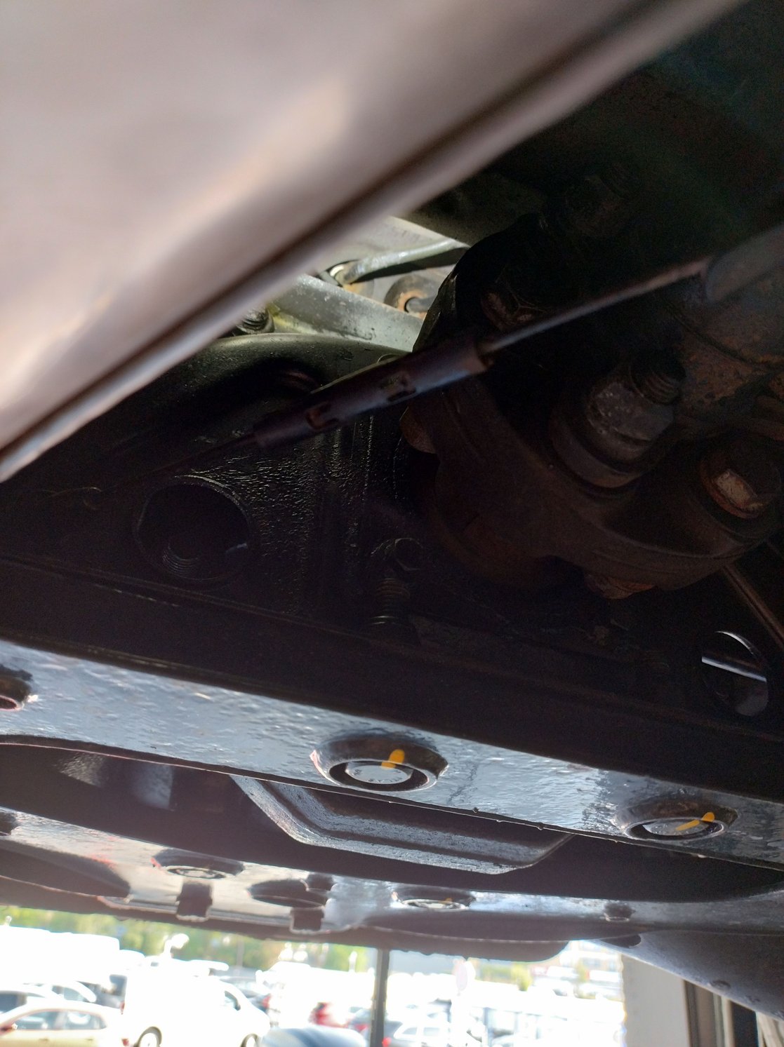

Took the car to the mechanic today, just basically paying to get an elevator.
Result: fuel filter is correctly mounted.
Fuel lines do not seem kinked I believe. It took us 10 minutes to find a good angle. The mechanic was looking at me as if I was crazy.
