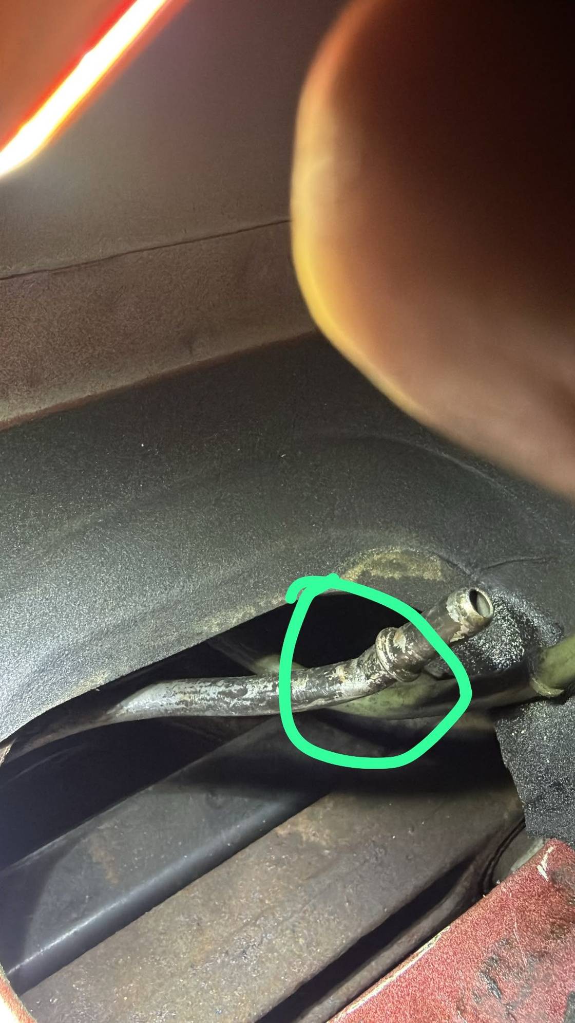

First feedback from mechanic is that pump needs replacement, he says it makes a lot of noise, which I suspected but I couldn't compare to anything.
He says piping is slightly bent, but that that 100% is not producing my issue.

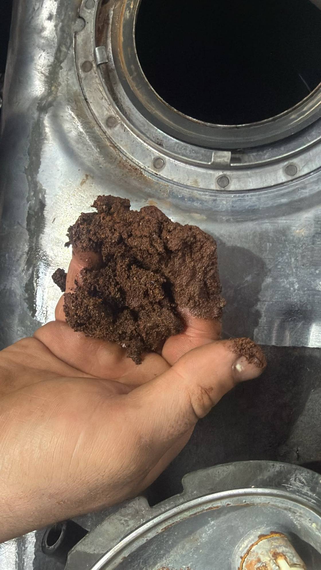

So, yellow fuel, residues and slightly bent pipe.
He says the pipe he can straighten it up.
He also says the pump was no suited for the Jag.
