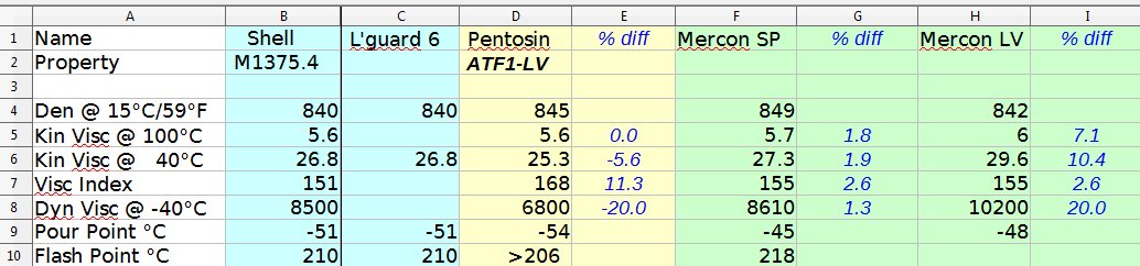

Yes it is and we have had many posts on this?
Mercon SP Threads.
Mercon SP Fluid
Again Mercon SP is EXACTLY the same fluid as Lifguard6. Shell makes both. One in their Houston refinery and the other over sea's.
Mercon SP Threads.
Mercon SP Fluid

That's just dye? They can make any fluid any color they wish? Shell decided to differentiate the two fluids and made the Houston version red.
I think it was to protect the Lifeguard6 pricing because when the 6 speed ZF first came out that darn Lifeguard6 was up and over $70 a liter! It come way down now so not nearly the same savings in cost.
