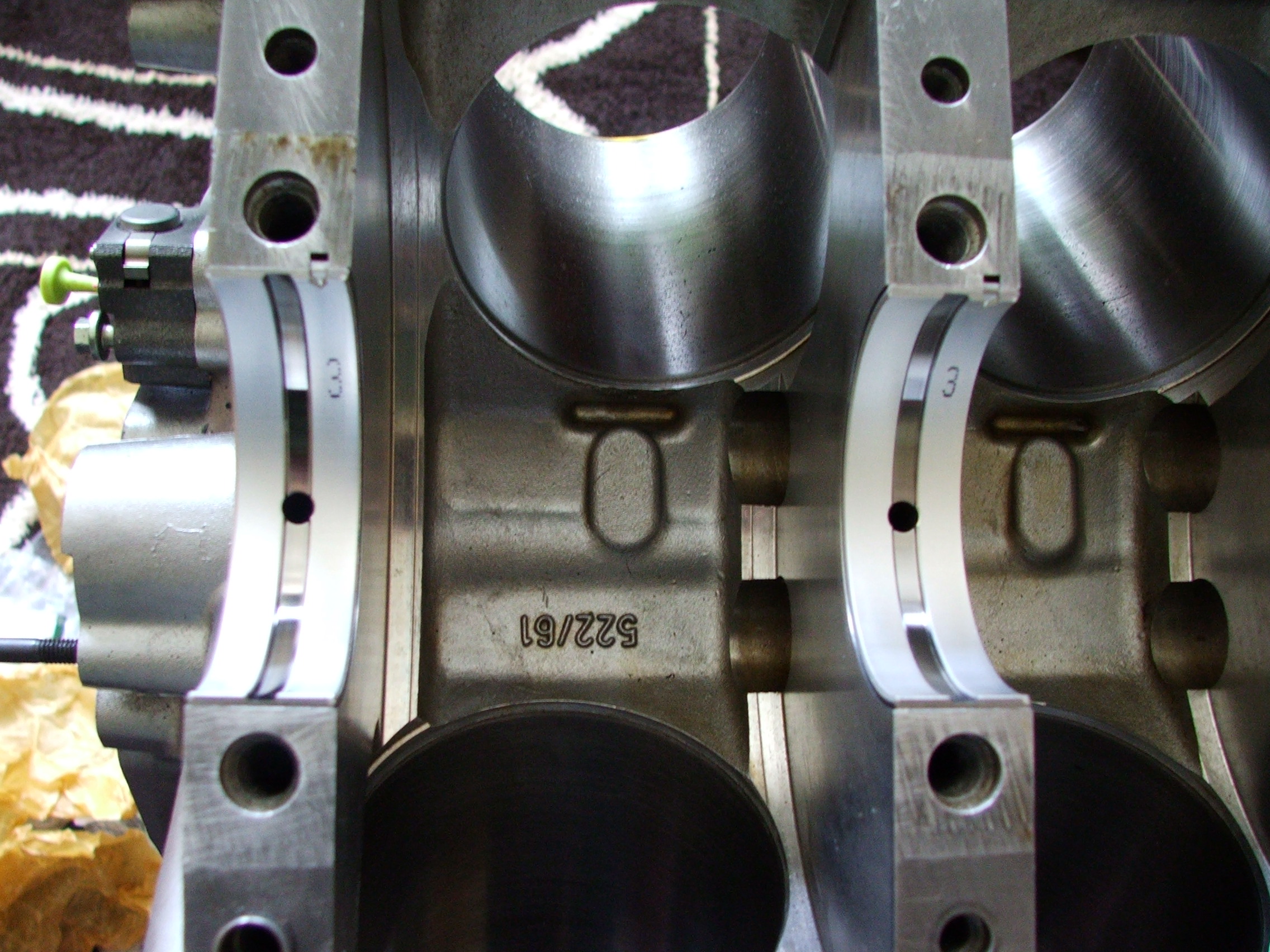

I also need some help on page 2 of this thread for main bearing #1 blue/green witch one is the grooved bearing

Belmont,
When I did the engine repairs on my XK8 I didn't do the main bearings but only a single rod bearing. So the info I'm giving you is from research I did and not from actual experience.
I found a pic of a main bearing with the oiling grove. I believe the grove will be on both bearing halves. When you order the bearings for the mains it will have the oil grove.

Originally Posted by BobRoy
Belmont,
Thanks I’ll look into it more. The bearings on the bed plate are not grooved while the bearings in the block are grooved. I’ll reread the pdf to find out

Like your storage box for the valve components. Where are your cam buckets, I put them with the valve they belong to. I also take the bucket shim off and mark its size on top of the box to its corresponding valve. I do this so when I'm adjusting valve clearances I know what shim is on that bucket and can calculate what size I need. Also drill a hole above each tray in your box. This way you can close the lid by guiding the valve through the hole. If you accidentally spill the box with the lid open you will never figure what part goes where. It is a little old fashion but it is the way I was taught.
I confirmed you main bearing sizes to yours. Install the bearings in the same configuration they came off.

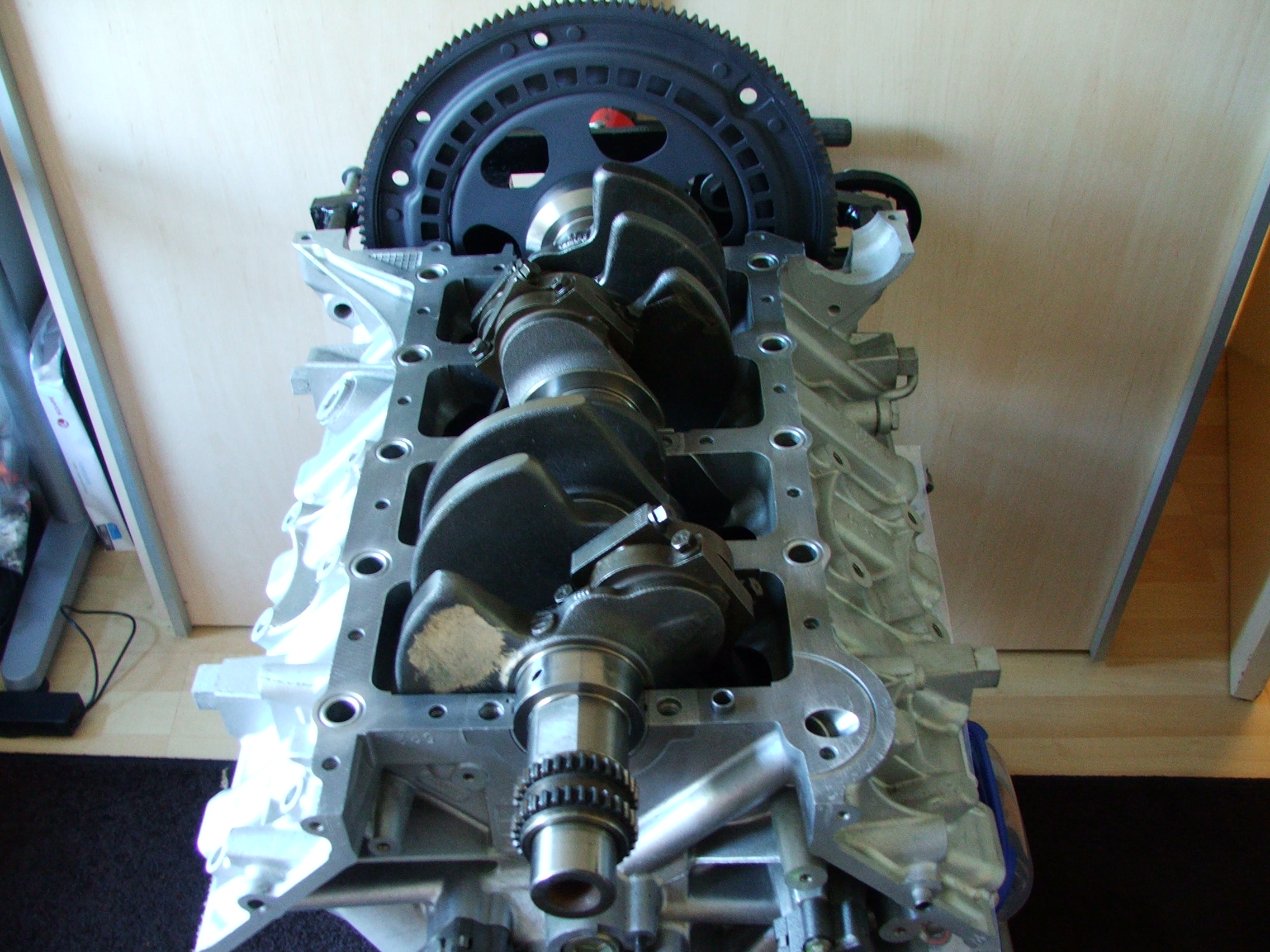

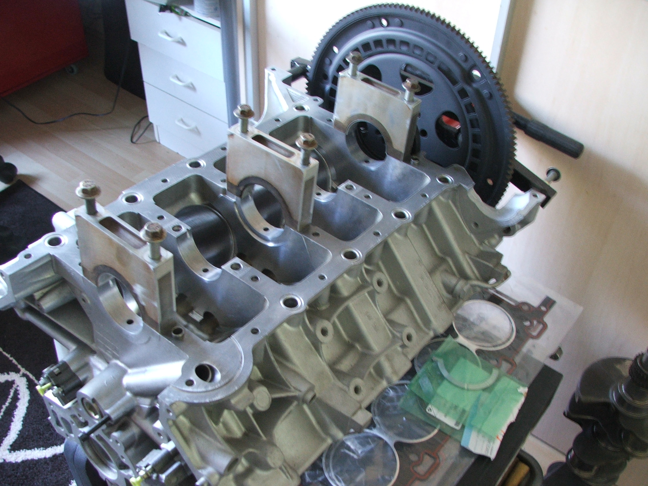

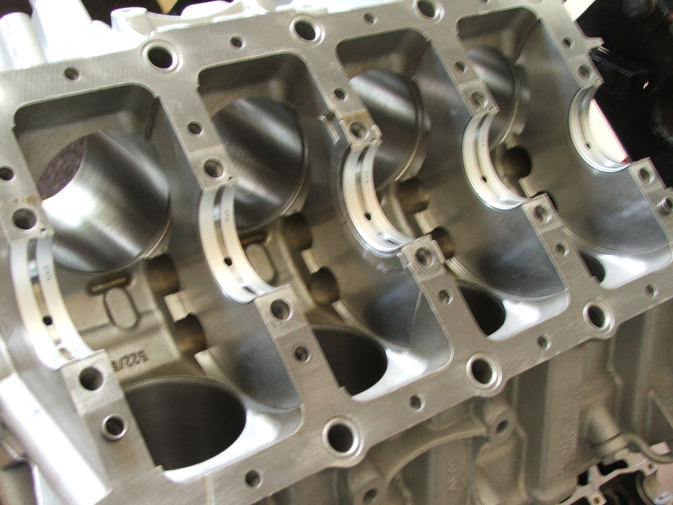

Valve shim adjustment can only be done with cams in, with a rather expensive tool from SPX (factory tool supplier) it pushes the bucket down on their shoulders so the shims can be replaced. I would love one!
When ordering the crank bearing set, don't forget the thrust bearings.
A dummy crank set tool made out of an old bedplate

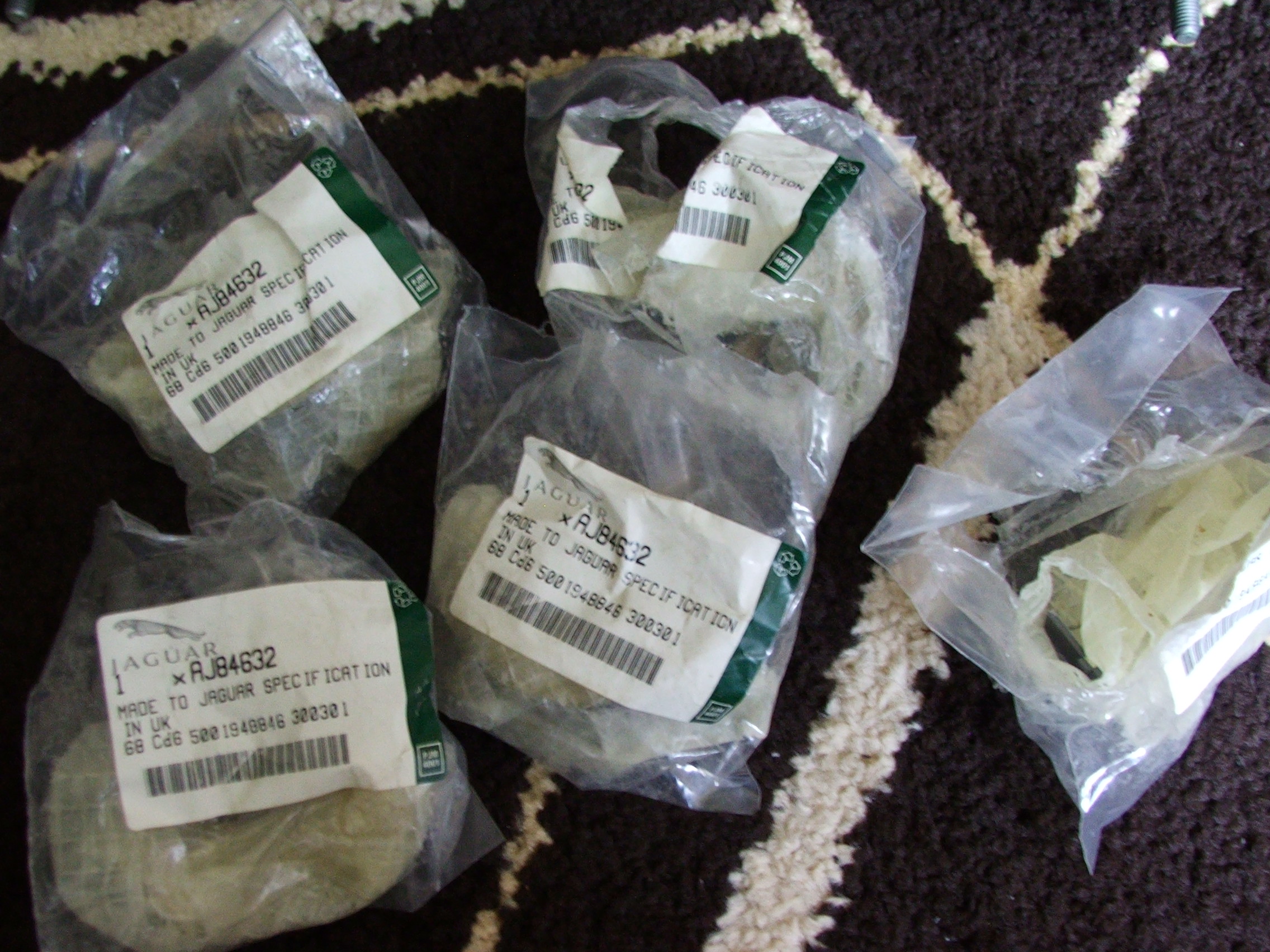

Little update still buying parts slowly engine parts have been cleaned have all of the bearings and some of the bolts. Will continue working on it once the head bolts and piston rod bolts come in
