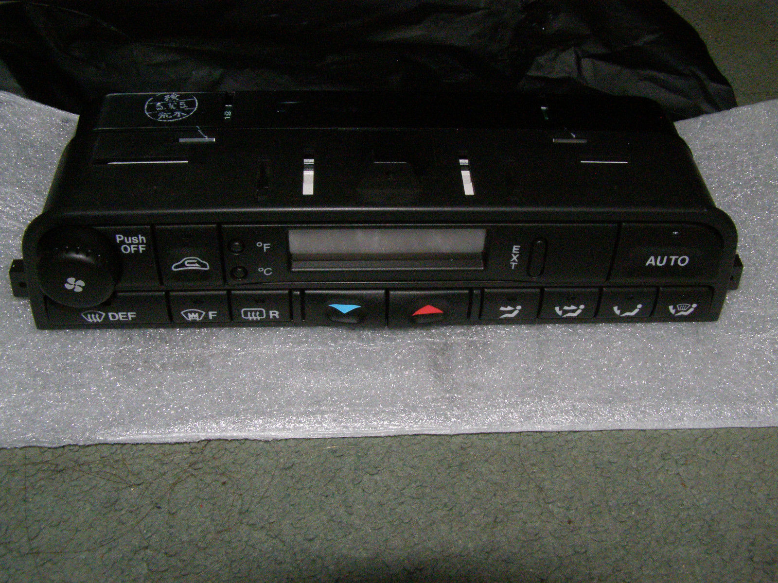

Another indication is a separate button "F" (right side of the DEF=Defrost button) for heating the windscreen on the climate control panel. But having the button doesn't mean neccessarily, that you have the heated windscreen fitted at the moment - they're expensive to replace and maybe a preowner wanted to save some money when replacing a cracked windscreen and therefore fitted the regular one without changing out the control panel as well. See pictures for control panel with and without front windscreen heating button.

If you’ve not got a button on the dash for a Front heated screen, you haven’t got a heated screen. Very simple to check.

The heated front seems pretty rare on US cars. XJR2014 has the right idea though, if you don't have that front heater button next to your rear defroster button, you don't have the heated windscreen.

Heh. Thank you for the easy check. No, I do not have the heated windscreen.
