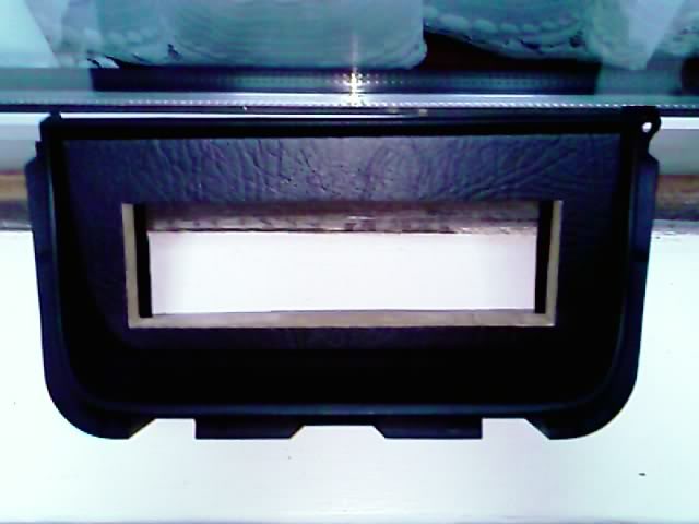

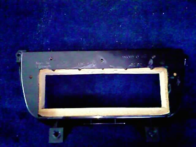

It is apparently a very niche market and money to be made for those who can do a good custom job of it.
I didn't attempt to find anyone to custom make it, so had a go at doing it myself:

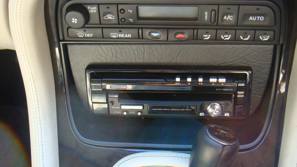

Fitted to the car:

I was referring to the link provided by a user earlier in this post. They have got a double-DIN monitor screen in the dash/console. A single DIN refers to the height of a standard after market car stereo; double DIN is then, of course double the height of single.
The Kenwood unit that I have installed is a single DIN unit, whereas that person who has a full screen in the console is of a double DIN height.

Yep, fitting just requires the ISO adapter, plug in and you're ready to go. You can, optionally, bypass the 'monitor safety/handbrake' wire (connecting it to a ground/earth source) so your passengers can still watch video content whilst the car is moving.
