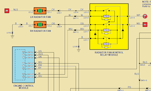

Tap on the fan control module under the car left fwd of wheel .

So the fan module is on the left side, forward of the wheel? For what it's worth, the fan will turn off after 5 minutes. I did notice that today, only one fan(the lower) was spinning after engine shutoff. In the past it was both.

If the fan or fans are eventually turning of by the module then the problem would be in the sensing of coolant temp or the coolant fluid itself may be abnormally high . The fans work as a single or both dependent on coolant temp sensing . You can remove and test the sensor in ice and boiling water
