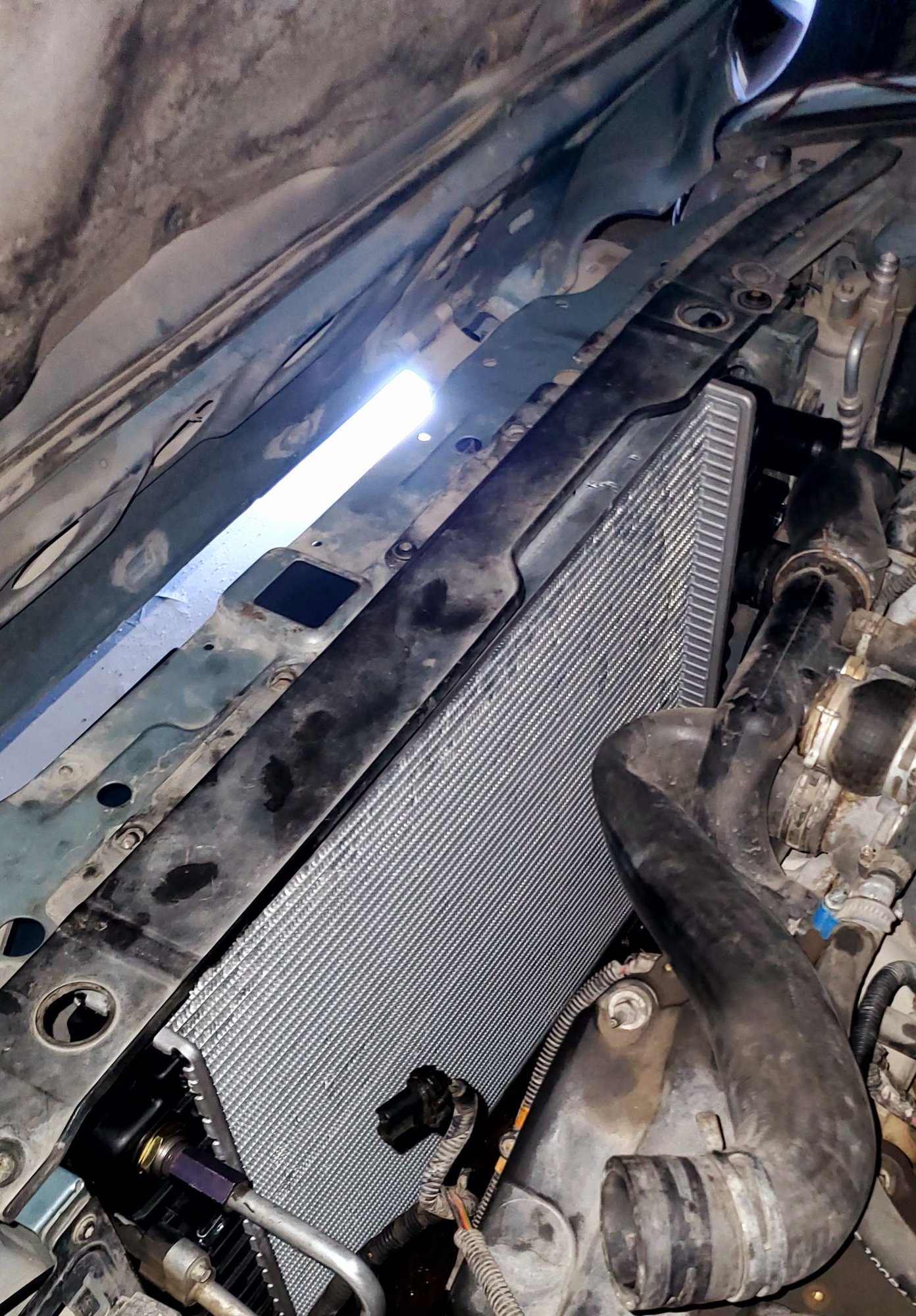

Hello guys after a long damn surgery for the car here's the radiator we had to cut the radiator mounts on the right side and hit part of the chassis itself with a heavy hammer to make more space by probably 1cm it was headache but for me worth it , the transmission hoses fit as the original radiator nothing to worry about still not yet finish we did need some parts to mount it properly and keep it tight the ac condenser I think we may use metal zip tie to keep it tight at least we finished the difficult part which sitting the radiator and the hoses we had to get hose from other car and cut I don't know which car my friend have small junkyard so whatever hose that fit it work I used 2 used radiator with 2 month the plastic tank explode epoxy doesn't work these radiators getting very old and the plastic tanks very dry easy to break and I won't pay 1000$ for radiator that's rip off to me
