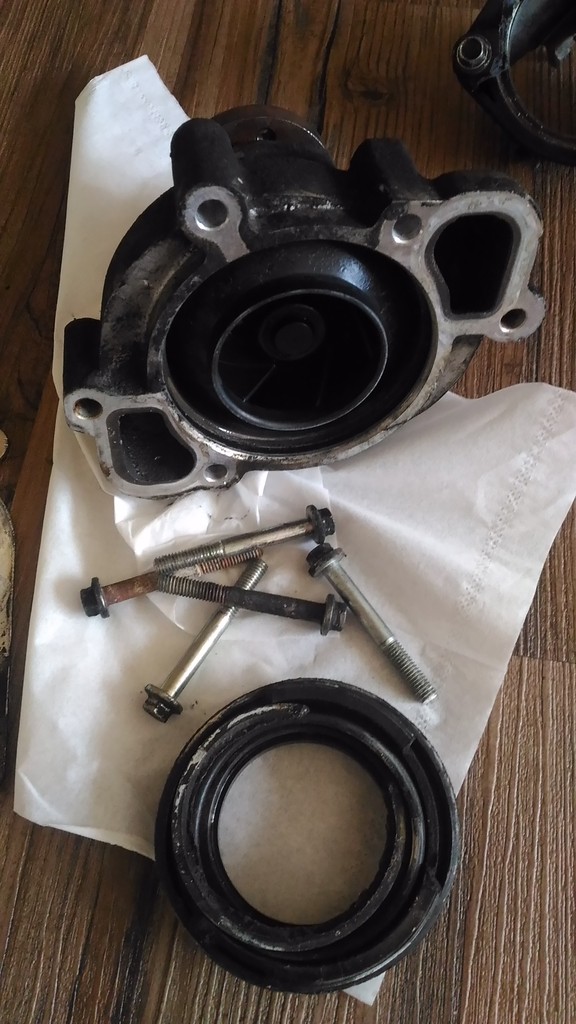

1. WATERPUMP
Got the waterpump out. It has the alloy packing, and the black impeller, and if I am correct, that means it is the first generation pump, correct?
The impeller is in one piece, but the shaft turns rough, looking like the bearing is shot. I remember to have sometimes heard a metal sound coming from the front while driving up, out of the parking garage, and this could confirm just that.
I will order a new pump.
2. THERMOSTAT
Just tested the old one against a new one. The old one refuses to open,where the new one perfectly does.
I guess the problem is found.

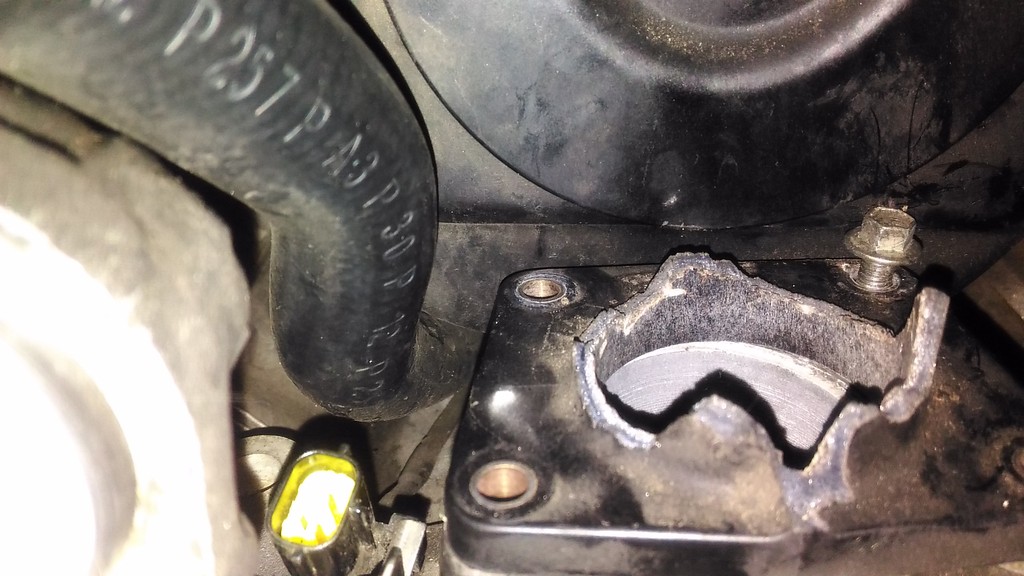

3. THERMOSTAT TOWER
I looked for 2 hours to find the correct tool to remove the rear 2 bolts of the plastic thermostat tower, but to no avail.
So decided to break it down, which was not a whole lot of work.
However, one of the bolts gets wedged against the front of the intake manifold. I think it is free of the thread, but simply cant go further up, and I am careful with putting a lot of force on it so far.
I hope anyone's got an idea, cause I am not really waiting to remove the manifold, which was just done 2 years ago with all new packings.
The car is parked in the shared underground garage, without power or air, so cutting it off might be difficult.

Did that water pump have a thick aluminum gasket on it? That looks to have an early replacement water pump as you stated if not the original pump. However, when I took the original one off my wife's 00' XJ, it had an off white color plastic impeller. So yours may not be original but certainly in need of updating. Certainly contributes to the noise you've been hearing. I can't be for certain unless you know how all the other pulleys feel.
Glad you found your problem with the thermostat.
The thermostat housing is a little challenging. I use a Snap-On 8mm swivel socket. It's a chrome 1/4" drive, short little guy that gets right in there. I use a curved hemostat to carefully finish taking those back two bolts out. If you can't get access to those two tools I mentioned, then you need to pull the intake.

If you search all the thermostat tower threads, you will see every now and then some of the rear bolts are too long -- you will have to raise the manifold. Occasionally these long bolts can be levered sideways if there is very little thread contact. But since you have removed the busted tower remnants, my guess would be you need to raise the manifold (or dremel cut the bolt heads off!).
Putting them back in is a real treat: use the shortest bolts from the thermostat housing and cut screw driver cuts in the bolt heads with a hacksaw or dremel tool: then you can screw them back in. I must have bought every damn 8 mike mike or 5/16 wrench or socket made to find one thin enough: nothing worked. Screw driver did; gets it tight enough that a few 15* throws with an open end wrench tightens it enough on the gasket. There are also some ball socket bolts available.
Don't forget to replace the cross over pipe, as well. I don't know what water pumps are available in the ROC, but I found the AC Delco to not leak. My first replacement never was water tight.

Thanks for the reply.
I never read on that particular problem, but nevertheless, nothing I can do about it anyway.
Do you think I will be alright with the intake seals if I just lift the front of the manifold a tiny bit to let the bolt out?
On the water pump, I saw some discussion on AC Delco and Airtex.
I guess I will fly it in if I can't find it locally, just need to make the decision on these 2.

Why not replace the thermostat tower bolts with cap heads (allen key)? Then you can use a ball head allen key to tighten them.

Installing is not the problem, there are several alternatives (shorter bolts, allen head, slot for screw driver).
My problem right now is to get this one out, it is free, but wedges against the front manifold housing.
If I had power, I should just grind the head off, but I haven't.
And I am very careful not to use brute force, and to prevent doing anything I will regret later.
So the question remains on the intake manifold seals if I try to lift the manifold just a tiny bit?
Will they drop out?
I have to order everything overseas, so I better first decide on what I will need.
Anyone any suggestion?

If you remove all the intake manifold bolts, you 'should' be able to tilt the front of the manifold up enough to get the last bolt out & same for installation. It all determines if the (2) 8mm bolts back under the throttle body elbow are on super tight or just snugged up. It seems to vary by whoever was there before because your intake gaskets were already replaced once. To answer your question, no the gaskets won't fall out. However, I'd take a peek at them while the manifold is tilted up to make sure they're in place.
Thanks, that is the confirmation I was looking for after I read about all threads on manifold removal by now.

If you were to break the base of the old TST tower out (pliers, chisel gently, whatever), I would bet the bolt will be loose enough that it will bend away to be removed (maybe a half of a thread holding it) so you don't have to raise the manifold. Right now, the base is holding it vertical.
I had terrible luck with the Airtek pump, leaked from day one: switched to the AC Delco, no leaks in two years. You might want to be sure your belt tensioner is good; mine broke at first belt change, order a new one too.

Well, this was simpler than expected.
I just loosened the 10x manifold bolts a couple of turns, and lifting the housing by just a fraction let me turn that bolt the last 1/2 thread holding it.
Sprayed the alloy thermostat-tower yesterday, using some satin black heat resistant paint I still had.
Looks like the original plastic one, and will stand out less than with the alloy color.
