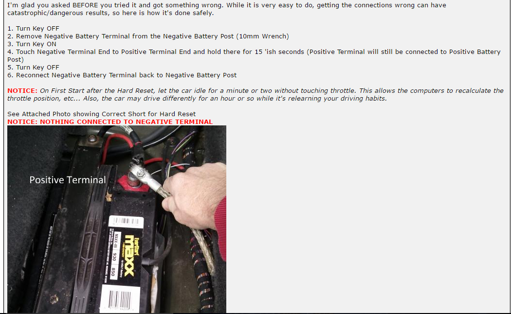

Did you check battery voltage?! If not then do. If you did and it is good try a hard reset.
Old Apr 21, 2017 | 04:44 PM
omgimali's Avatar
Joined: Jun 2016
Posts: 1,489
Likes: 107
From: Cheraw SC
Hard Reset to the system.
