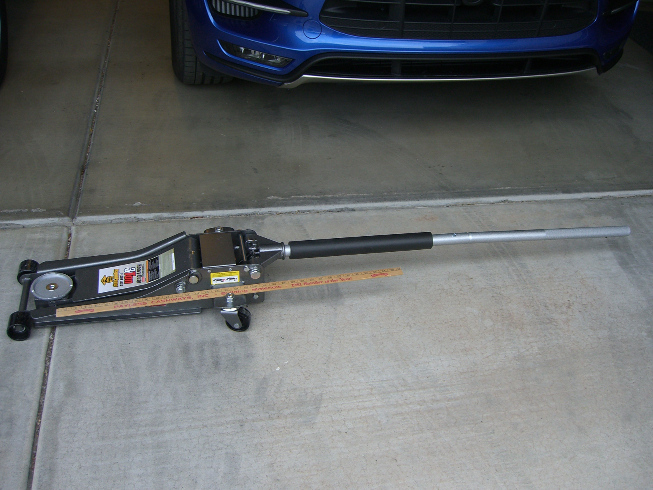

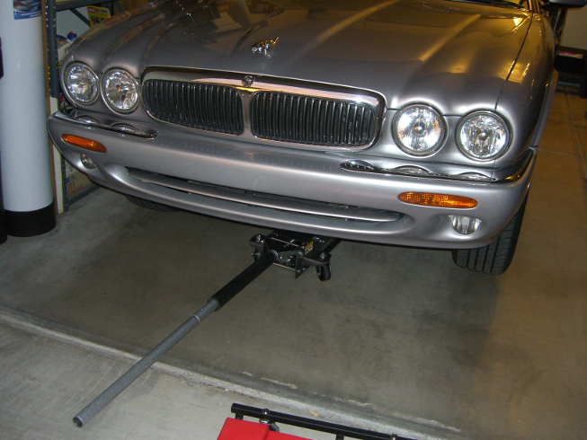

Some pix:
Both FJs in box/case, Each one shown with yardstick & Pittsburgh 3 Ton, Low Profile, Rapid Lift FJ in desired position to lift my XJ8 from front suspension crossbeam.

I've used the same old FJ for years on a variety of my recent Jaguars (XJ40, X300, X308, XK8, XK) and other vehicles. Doesn't look pretty any more but it's reliable!
It has a similar problem of almost no movement on the lever with the vehicles on level ground.
I get over this by jacking under each spring pan in turn and standing the road wheel on a short length of 3 inch by 7 inch timer joist offcut to raise the front of the vehicle. Very quick and it means I can then easily use the FJ under the cross member etc.
