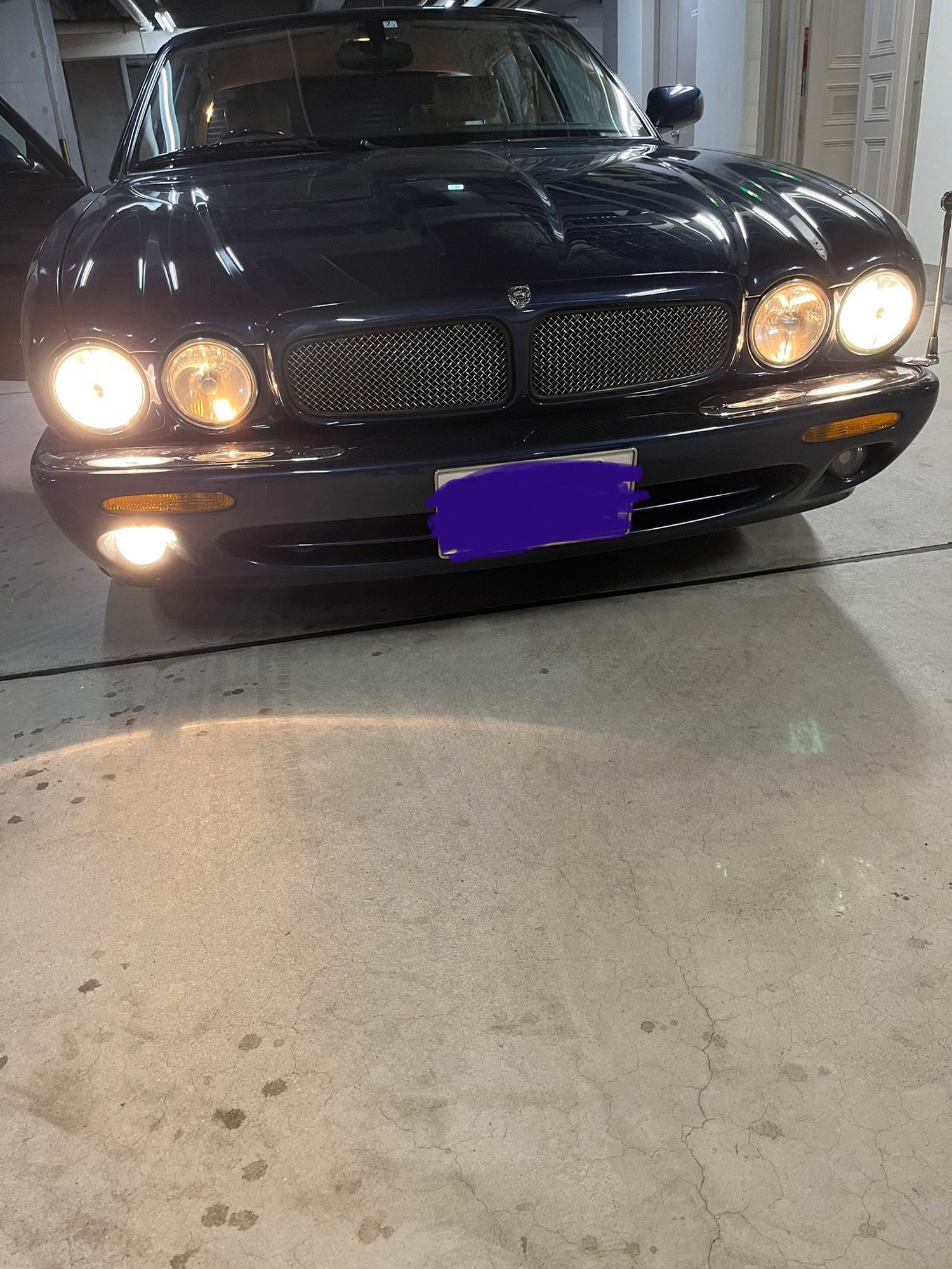

One of the front fog light bulbs finally gave up.
Are there any special instructions for replacing?
They seem kind of hard to get to.
