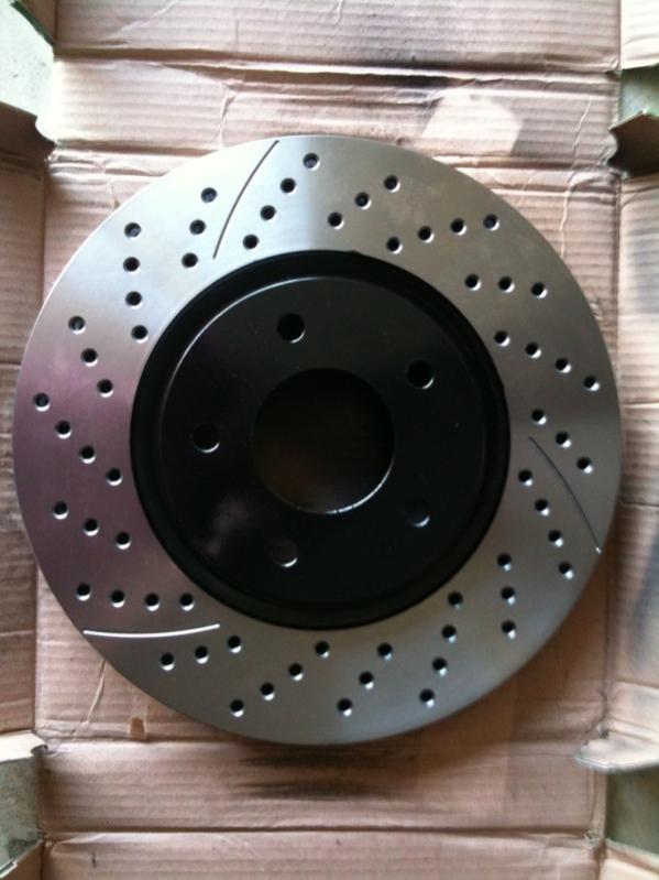

I am also doing a brake job on my 2003 XJR. I bought tires(Michelin Pilot Sport A/S Plus), Disc Italia rotors(pic below) and Hawk HPS pads. I wavered on the stainless steel brake lines due to conflicting reports of whether it would increase my braking or not. I'll spray the calipers since I'm at it, black.
Basically its stage one of my upgrades. Starting from the bottom up.
In the pic, I am showing my new Disc Italia rotors that I sprayed the hub with black high temp paint to limit rusting.
