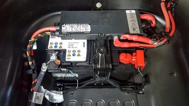

Just to expand a little on Borbor's spot on statement regarding removing the Battery Monitor (BM) from the charging loop and to clear up the confusion regarding where to wire in a CTEK, or any other charger for that matter. The BM acts as a minuture ammeter, measuring the current flow through the battery. It is placed between the battery grounding strap and the battery negative post "in series", as you would when connecting any ammeter to a circuit to measure current flow. It's difficult to see clearly in our F-Types as it is tucked under the rear boot panel. You can see it clearly in this F-Pace install, which uses the same BM.
If you connect a battery charger directly across the battery terminals, you bypass the BM, removing it from the charge circuit. As the charge current does not flow through the BM, it cannot monitor the current flow through the battery. By connecting the negative charge cable to the battery grounding strap, the BM remains in the charging circuit and can monitor the charge current. You can connect the negative charge cable to ANY ground point on the car (including the jump start earth stud on front wing), as the current flow will always return to the battery via the battery grounding strap. Likewise you can connect the positive charge cable to ANY battery positive terminal, from the battery postive post, boot/trunk main fuse box bus bar, or the engine bay fuse box/jump start terminal. Any and all of these connection methods will keep the BM in the charging circuit and able to monitor the charge current. The ONLY method you should NOT adopt is to connect directly across the battery terminals.
