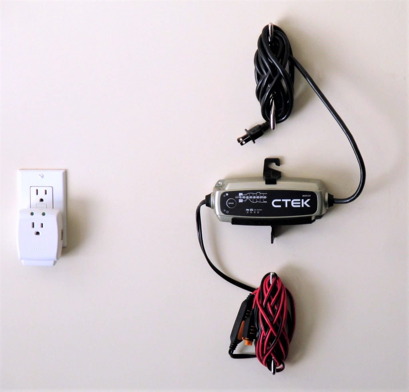

I'm too paranoid about water intrusion to leave the connector hanging out of the vehicle, rubber plug or not. Murphy's Law and all that. I am fortunate to have an electrical outlet on the wall next to where I park my Jag so my CTEK unit is installed next to it. I live in the mountains and thunderstorms are common so I do have a surge suppressor on the CTEK plug just in case.....
Here's how it looks when not in use. CTEK sells the plastic mounting bracket and the unit just snaps in. And I bought an extension to reach the hatch area of my car. You could also mount the unit to any surface with a couple of screws.
