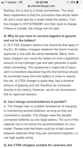

I am not sure which C-Tek charger Abonano has, but my C-Tek MUS 4.3 smart charger specifically calls for the negative clip to be clamped to a grounding point on the chassis/engine block, not the negative battery post, which is the same protocol as when the car is jumped.
If the battery is removed from the vehicle, you can connect both clips to the battery posts.
Have I clamped the charger to the negative post? Yes. It didn’t cause damage, but it is good practice not to.
Make sure the battery is vented while charging and keep an eye on it especially if you leave the charger on for extended periods of time. What type of charger are you using?
Here is C-Tek’s explanation for connecting to a ground versus the negative battery terminal:

Just checked instructions again - yes, connect to a ground point on the chassis, however, I'm not messing with those aluminum ground studs, nope...

The C-Tech instruction not recommend to connect to the neg. post just for the liability reason, so doesn't matter ground or neg. post.
