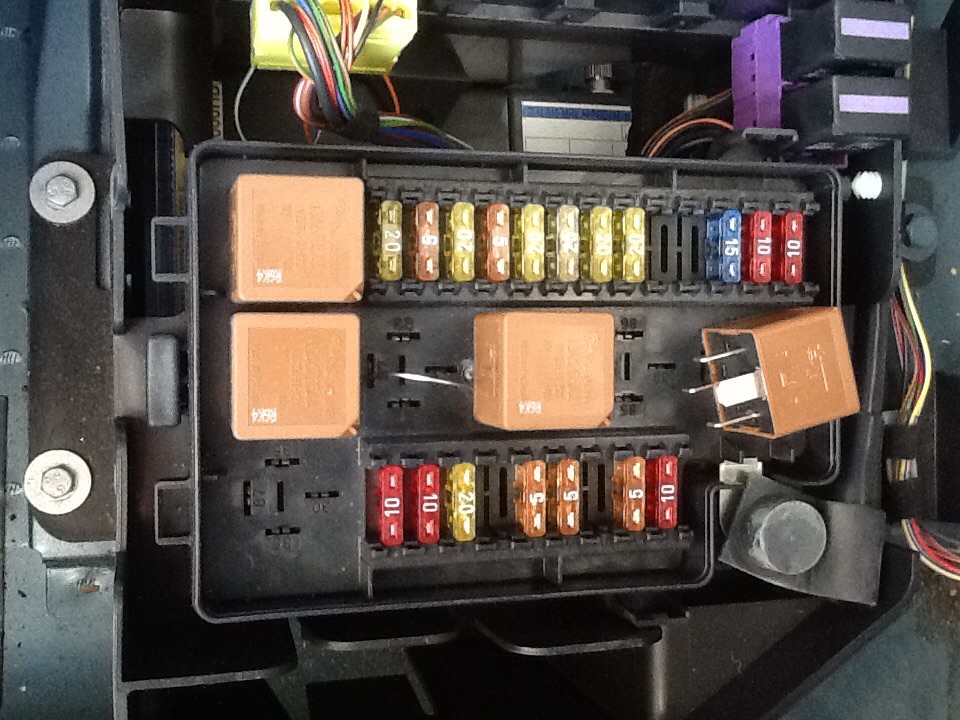

You should be able to hear the fuel pump running if it is getting voltage. There is also a fuel pump relay that has to pull in in order for the fuel pump to function. I removed this relay on my car and jumpered across the socket so that my fuel pump would run without starting my car. Send me an email and I will send you a picture. I am not sure how to post a pic here but I will try. The relay is located in the fuse panel next to the battery in the trunk. The relay removed and jumper wire installed can be seen in pic. Check for blown fuse first. Most of these relays are interchangeable, so you might try swapping them to see if the relay is defective if the fuse checks good. Good luck...

It is entirely possible that the fuel hose might have blown off the fuel pump inside the tank if you hear the pump operating and have no output. One of my clamps failed when I replaced my fuel pump...buy new stainless clamps. Good luck.
