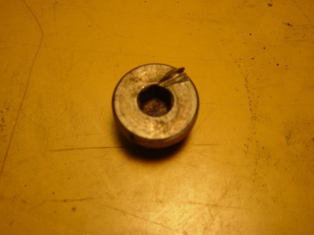

I need to top up the fluid in my gearbox, because it's now been established A. Moron has been at it previously. Further evidence is below:
FFS!

I had one like that on one of my cars. I took a chisel and at a 90°angle I put a cut in it. Then put the chisel in that cut at about a 45° angle. Then hit the chisel until it broke loose. The plug will need to be replaced.

Holy cow!!....there really are some dumb ***** out there....I had to deal with this on my box.
I used a six point large Torx bit...can't remember what size...FB ;o))....hammered it in on a long extension
and used a long breaker bar to loosen it after apply a little heat tot he surround area....CRACK!!....it came loose!
The new plug went back in with a little Nickel ant-seize on the threads....and was torqued to 30Nm.

I took a plug out of a transmission and this is what will fit.
8mm allen- This is what I normally use
5/16" allen
T-50 torx
A cold chisel if you don't have one of these other tools of if is stripped. "NOT RECOMMENDED "
