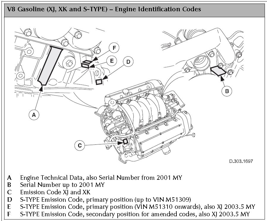

Originally Posted by avos
What is your engine serial number?
Which car? The XJ8 or R?
And I should ask where to find the number on the engine?
Old Jul 7, 2013 | 12:31 AM
avos's Avatar
Joined: Apr 2008
Posts: 3,616
Likes: 1,070
From: Europe
Although I referred to your post with your xjr, you can give both of course
Attached Thumbnails Genuine Jaguar exchange engine rebuild spec?-engine-serial.jpg
Please excuse my ignorance, but just where on the engine is illustration 'A'. My 98 should have a number as defined by illustration 'A' but there is nothing there. I suspect the engine may have been changed out...
Old Jul 19, 2013 | 11:29 AM
  #29
avos's Avatar
Joined: Apr 2008
Posts: 3,616
Likes: 1,070
From: Europe
The A spot is for engines from 2001, so if you think you have an engine from 98, you need to check the B spot, and that one is sometimes hard to find, especially for supercharged cars iirc.

Likes: 16
From: Kissimmee, FL
I did check the B spot and there is nothing there...no maching or rmarking of any kind.
I was actually wondering where the A spot is on the engine so I can look there as well. I'm thinking the A spot is under the exhaust manifold on the left side but not truely certain...
