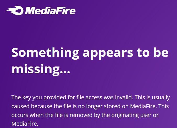

Thanks Highhorse but that was my point?
We have lost GGG and all his fine documents so the manual in your linked thread is now dead. We did just have another member looking for this to. I try to snag all the manuals I can and I don't have a copy of this one yet.
Here is what you get when clicking the old link.
