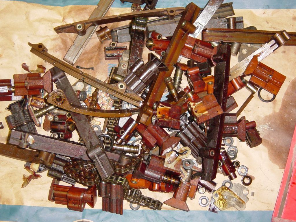

Old Oct 26, 2016 | 04:14 PM
booyaford's Avatar
Posts: 41
Likes: 5
From: bath england
now that should be an exhibit in the tate modern
