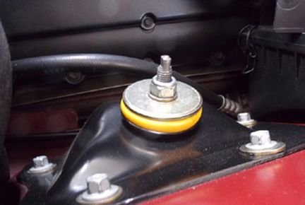

I think the only VDPs with Computer Adaptive Technology Suspension (CATS) were the later supercharged versions, pretty sure your 2001 VDP has the non adjusting suspension, with the comfort shocks.
Look at the top shock mounting plates under the hood, if they look like the picture below, it is the standard suspension, if they have a black, plastic, coned-shaped cover with an electrical connection wire coming from them, they are CATS.
thank you!
