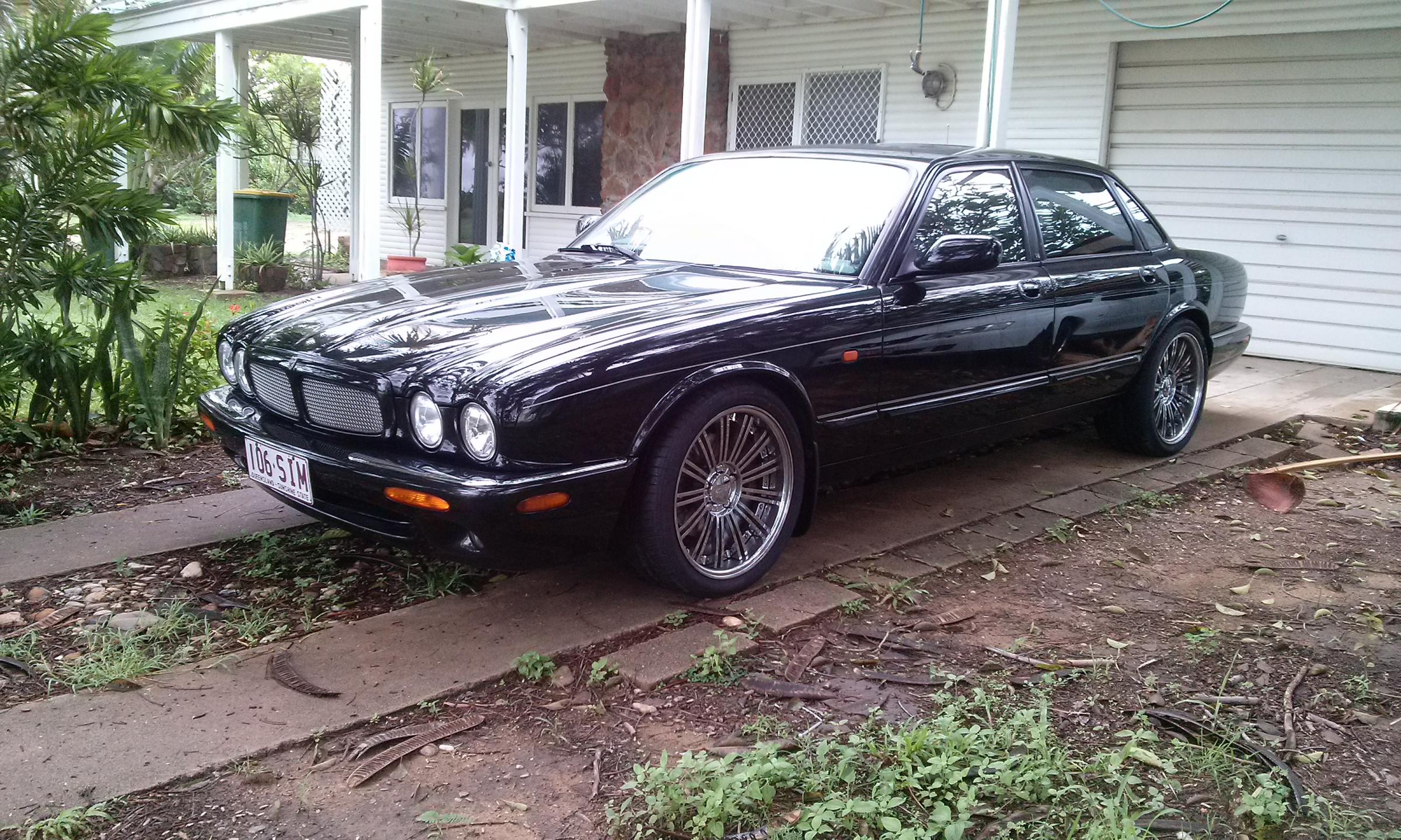

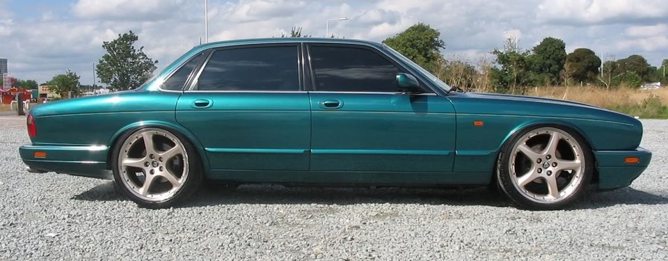

I spent a lot of time chasing rims and tyres, I ended up with
18" X 9" with 25mm offset
tyres 275/35X 18"
If I did it again, I would use 35mm offset - nothing scrapes, but there is still 25mm clearance on the inside rear
Attached Thumbnails Help with Coventry wheels on a 2002 X308-cam00006.jpg   Help with Coventry wheels on a 2002 X308-cam00008.jpg

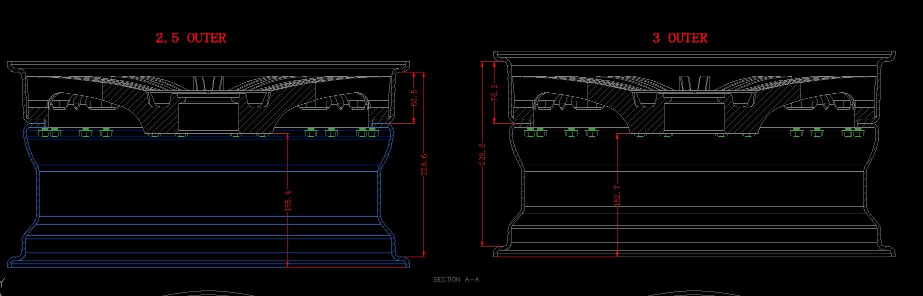

sorry, this did not upload first time 3" outer is the 25mm offset

Thank you, dc4prez.
looks good from here!. Thanks for the wheel's drawings as well.

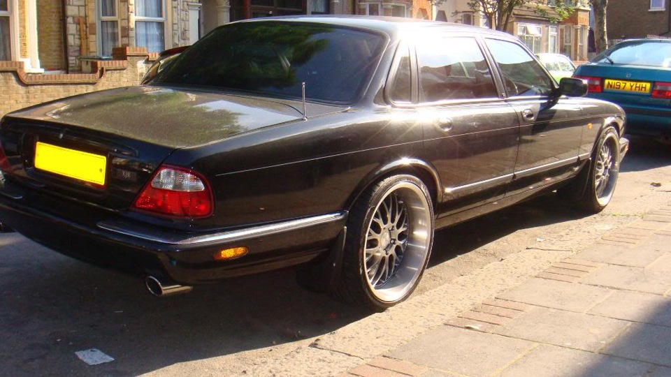

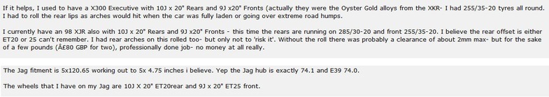

Before i decide to make this setup i've made a smell research.

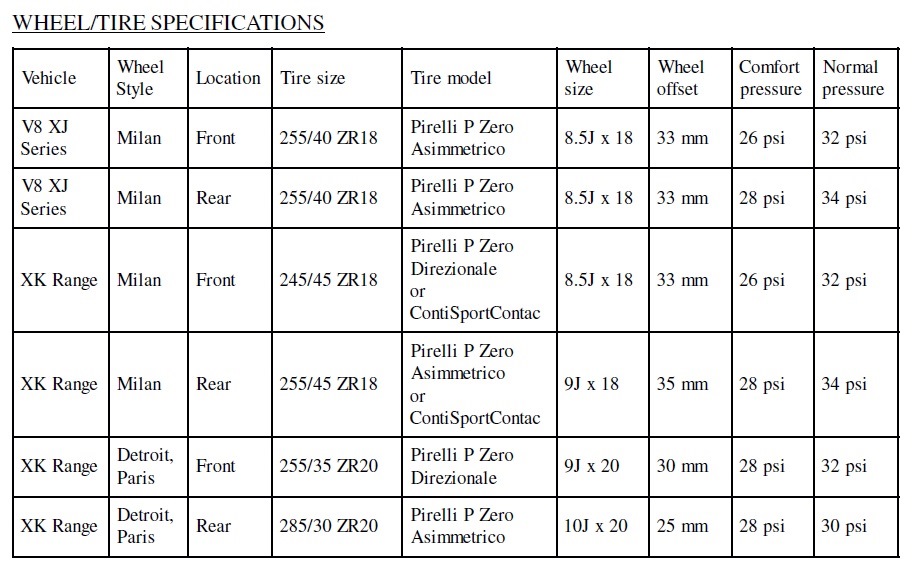

I find the photos of X308 with 20" Detoits from XK8.
As you can see from the list it has ET30 in the front and ET25 in the rear.
So i was sure ET25 with 275 tyres and 9,5 will work. Then i'm starting to look at the front axle. I faound some guy here (do not remember the nickname) and he show the photos of his setup.

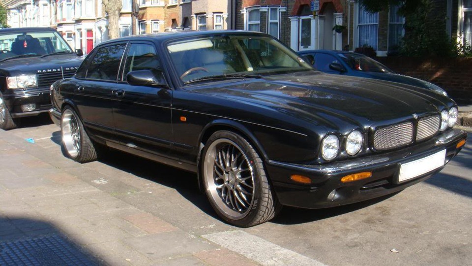

His X300 on 20" Detroits

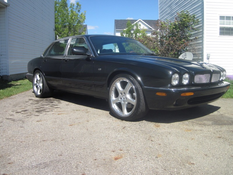

And his X308 with custom 20" wheels.
And then i found his description.
I will be usind not so wide tyres and rims so i'm sure it will work.
Attached Thumbnails Help with Coventry wheels on a 2002 X308-32a4d24s-960.jpg   Help with Coventry wheels on a 2002 X308-12a4d24s-960.jpg   Help with Coventry wheels on a 2002 X308-25a4d24s-960.jpg   Help with Coventry wheels on a 2002 X308-b9a4d24s-960.jpg   Help with Coventry wheels on a 2002 X308-59a4d24s-960.jpg

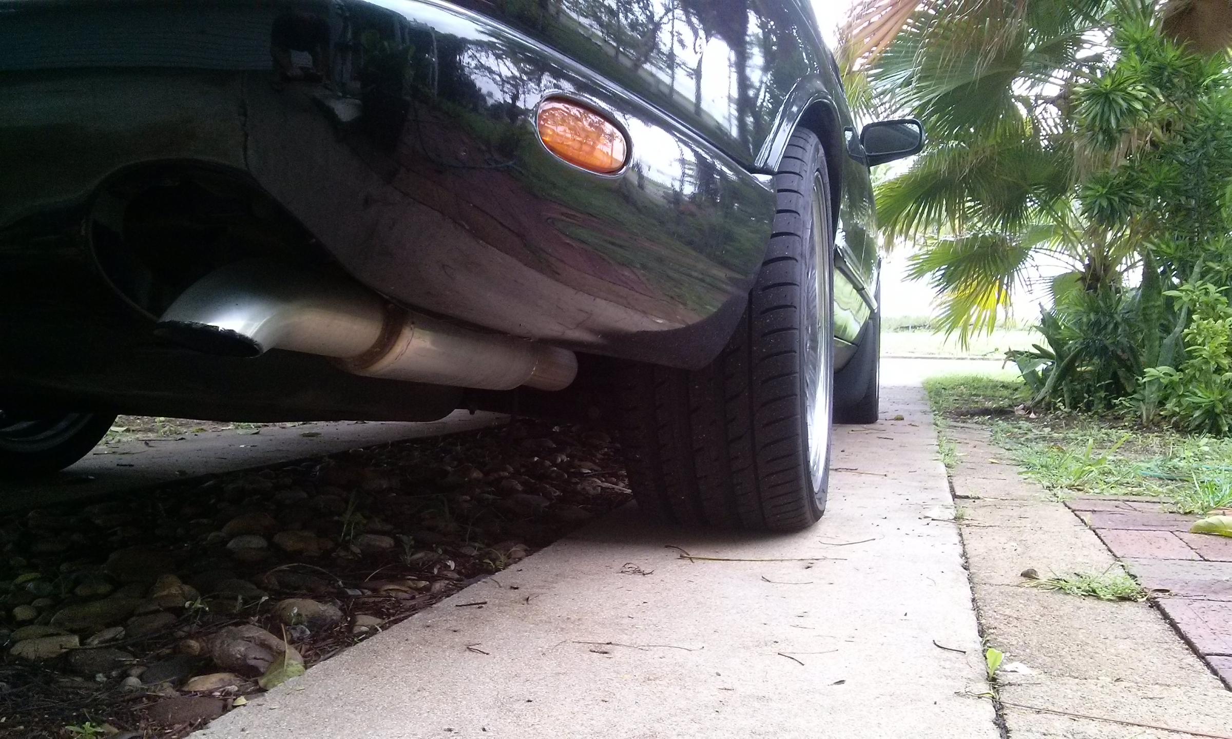

I have no clearance with 18"x 9", no fender mods were necessary. I saw the photo's - and the spreadsheet - Good luck
Attached Thumbnails Help with Coventry wheels on a 2002 X308-cam00017.jpg   Help with Coventry wheels on a 2002 X308-cam00019.jpg
