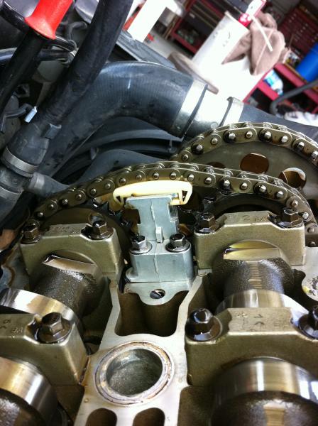

You could join the free MaxPerformanceCars.com Jaguar forum as they have a 'loaner' set of tools that with shipping will cost about $35. That forum was very active at one time but has become quite as of late.
GordoCatCar, who posts here also, is the tool master.
The ones you show pics of look the right ones. They have a metal body, the slipper has a plastic cover on its.

Quick update - I bought the secondary chain (master-linked)/tensioner rebuild kit and replaced the broken chain and tensioner on the passenger (US) side and was able to change just the tensioner on the driver side since the chain was unaffected. It all went very smoothly and the kit came with gaskets and seals for the reassembly.
I did not use the cam or crank locking tools, and after chains and tensioners were in the 4 cam flats were within a degree or so of being aligned simultaneously.
But still no start and really no signs of ignition, which surprises me a bit. I put in new plugs and am getting fuel. The spark looks weak to me, but there is spark - I would like to put a meter on the coil and see if it reads within range.
But more disappointing, with all cams turning I am still getting bad compression readings on at least one cylinder and need to check them all this weekend. I would like to check the cam flats with the crank lock plug installed also to make sure things are not totally out of sync.
It seemed worth a try to repair the secondary timing parts and re-test, but pulling the heads is looking more and more like my next task. Hopefully getting the heads out will not be impossible to achieve without a lift to get at the exhaust manifold.

Thanks Marc, but this thread was followed by others where I rebuilt the entire timing chain system and restored the heads, generally restoring from the block out. It turned out I didn't have any damaged valves and following the proper setting procedure for the cams and VVT advance resulted in a successful restart.
I think my first attempt at a limited fix of the secondary chain was unsuccessful because I didn't go all the way on locking the cams and resetting the timing to the crank position. I'm glad I went the whole nine yards as she runs great now.

I just purchased a 97 xk8 with broken drivers secondary tensioner. Reading this post ,is it possible for a secondary chain tensioner to fail completely and have the chains replaced and NOT have bent valves? I was able to use a boroscope to check the pistons and did not see any contact marks on the pistons. I thought this was strange since this is an interference engine but reading this post has given me hope? This falls into the "give it a shot" category? Thanks for any replies. Jeremy
YES, this is a give it a shot for sure Jeremy. My 4.0 XKR had 2 failed tensioners and a retarded timing exhaust cam drivers side. It's all good now. All I did was go to the Ford dealer and asked the man for both side tensioners to fit a 04' Lincoln LS 3.9L.
These metal tensioners vs the old 2nd gen plastic ones seem to rely more on oil pressure than spring pressure to work correctly. Upon cold startup, I can hear the chains for about 1 second. Good enough. I just turned 80,000 miles. When I get to 100,000 I plan to replace all 4 chains and related parts. At the rate I am going, this wil be in about 4 years.
@97xkeconv (that sounds like a nice car !) yes it is possible for the secondary cam chain tensioners to fail and the valves and pistons still be fine. It is an interference engine, but, if the chains do not jump more than one tooth, the exhaust valves will not hit the pistons. If a chain breaks, all bets are off. If you catch this issue in time, it will save you a lot of time and money.
well...... I purchased the car with the valve covers off and the drivers secondary chain completely off the car. I am still going to try;much hoping and even some praying will be involved.Oh does anyone here know of a tool set for purchase or rent or whatever I can do to get them?Well except for buying retail-too cheap for that. Thanks for all the replies and I'll let you folks know what I find.
The cam locking bars aren't necessary and a little bit over kill for your repair in MHO xkeconv. It is perfectly obvious when the cams are all in time with each other. Getting all the cams with all 4 flats level with their heads sounds like a lot, but it may be you only have one cam to time right now if I understand you correctly. I'll even suggest finding a secondary cam chain with a master link, so you don't have to remove the primary cam chain. I haven't had to replace any chains on mine yet myself, but I have heard those are available on Ebay. It stands to reason Ford might have them too.
For my time and money I would recommend using the tools.
The answer to your question is yes - my valves were undamaged. I did however try to eyeball (and used a square) my timing after doing just the minimal part replacement and the results were not good. Using the tools and following the official procedure, however, the results were exceptional.
Besides, it is an interference engine. If you get it wrong, there is still time for that valve damage to occur before this is all over.
