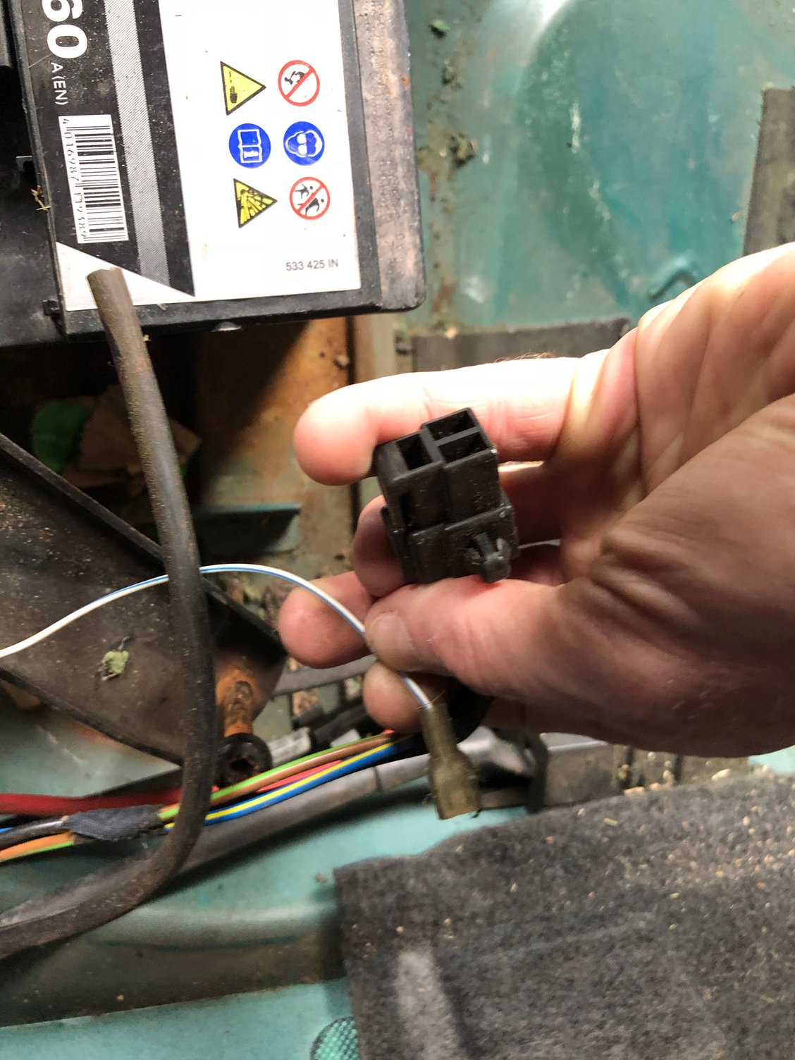

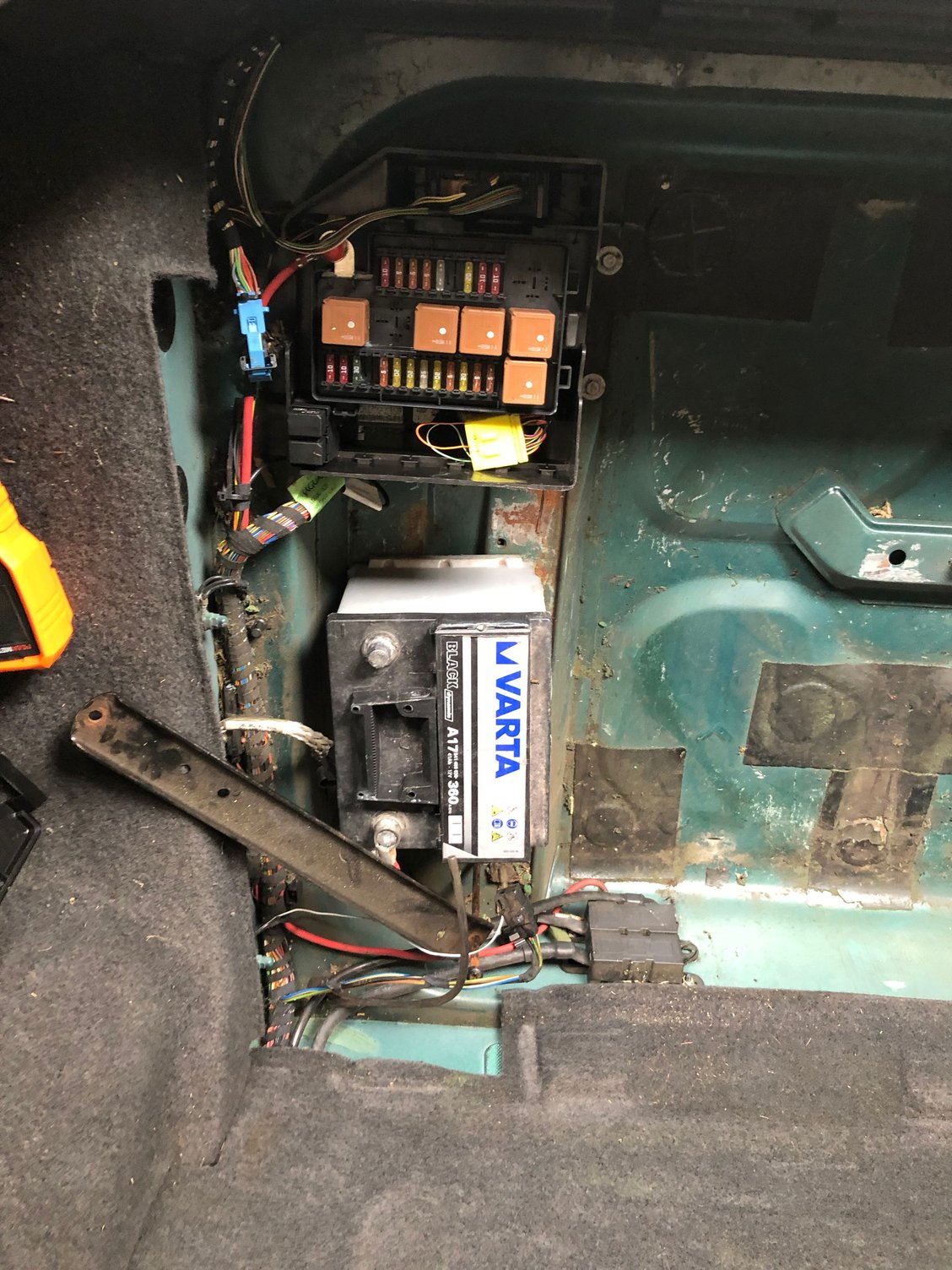

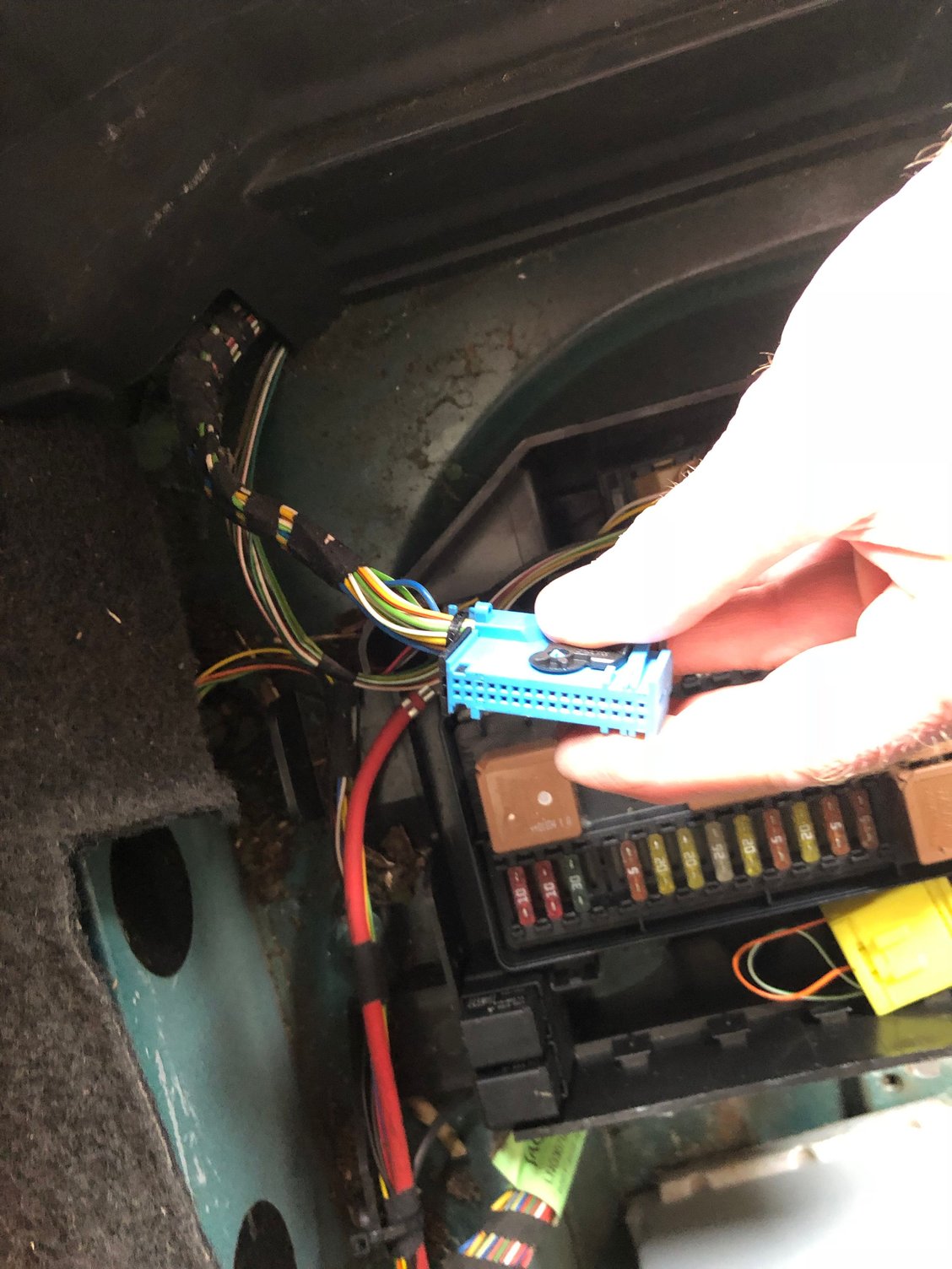

Hi lads , another q while I trouble **** my gearbox codes . Changing the battery as it’s a 45amp unit lol and found some unused connectors . Can any one id if I am missing something or are for accessories I dopn’t have ???
Unused connector at rear boot fuse box
One spade and one multi connector unused in front of battery in boot
Boot shot and tiny 45amp battery

The blue plug is an unused accessory connector. It should be powered when the ignition is on. It can be used for 12 volt accessories you might add in the boot.
The black plug with one wire is the "in transit" battery isolator that is installed at the factory and removed once the vehicle arrives at the dealer. Just tuck them away and they will be fine.
