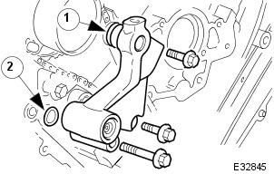

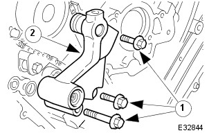

When you refit the bush carrier, there is a part of it that fits inside the VVT in the front. See pictures below - these might help
Remove the VVT bush carrier from the A-Bank.
  1. Remove the three bolts which secure the carrier to the cylinder block.
  2. Release the carrier from the two ring dowels and remove it.
