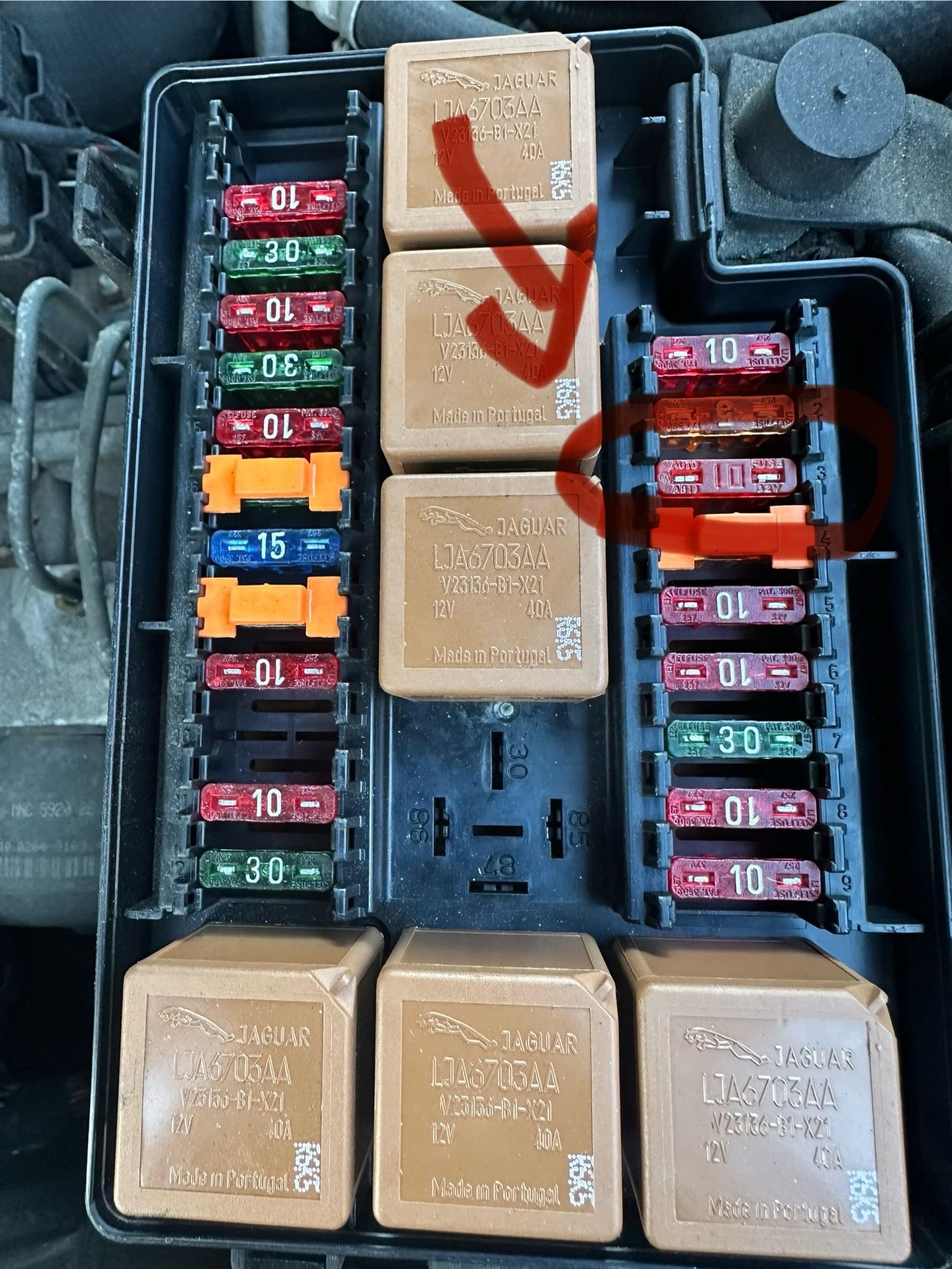

Thumbs up Screen washer pump not working
Hi All
Just want to say a big thank you to everyone who came back to me with advice etc.
The good news is that it is now fixed.
After a careful re-read of the fuse box lid in the boot (see pic) and the use of a newly purchased 12V fuse tester (£9.99, ebay) i found that fuse F3, left hand engine bay fusebox (see pic) was blown, which turned out to be the culprit!
Happy days
Ive attached a couple of pictures to possibly help out others in the future.
Thank again
Pat

Well done for working that one out, I can't see anything in the F3 description that'd make me check that one.
