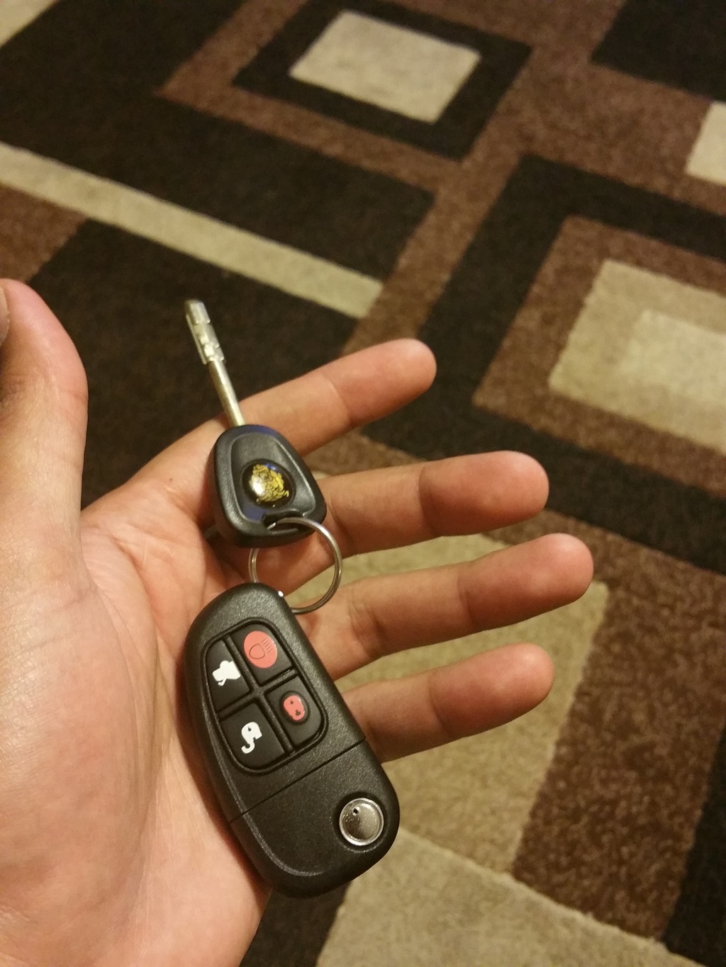

here are some pictures of the key fob....
problems with this key fob...the uncut key is a different size unfortunately as you can see from the picture below
my actual key is longer length than the uncut key
