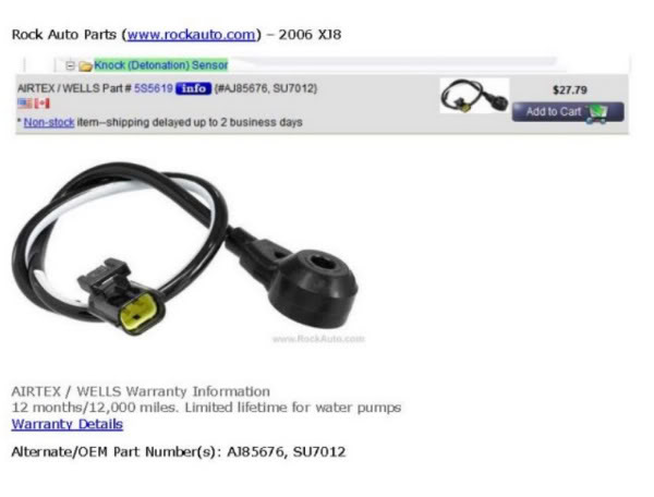

I did a little research on the internet this morning, looking for 2006 XJ8 knock sensor.
I found 2 sources here in US and 1 in the UK.
Rock Auto Parts has a Airtex part# 5S5619 that is an alternate/OEM for AJ85676, SU7012 - Price $27.79 plus around $9 shipping.
The other one is on Ebay is also Airtex part buy-it-now priced at $40.42 free shipping:
Airtex 5S5619 Knock Sensor | eBay
British Parts co uk has the original Jaguar part AJ85676 priced at 17.82 British Pounds - total cost 28.52 British Pounds.

The part number that David provided in this DIY writeup was the alternate for Jaguar part# AJ85676. Rock Auto Parts Airtex 5S5619 is also the alternate part number for it.
David it not go by the cross reference you are trying to use.
That is why I used 2006 XJ8 to look it up on Rock Auto Parts catalog.
Jim Lombardi

Update - the OES knock sensor ant17 bought on Ebay is also for the 4.2 engine - I just look at the compatibility chart in the Ebay Listing.
The Ebay listing for AirTex knock sensor has a compatiable table showing 1997 thru 2002 XK models with 4.0 engines along with all the 4.2 engines.
The knock sensor that David describes in the DIY and used is also for 4.2 engine. Both knock sensors are made by DENSO to Jaguar specifications.
Forum member luc posted "The AJ85676 is designed for the 4.2 engine ( BTW $27 is the full jaguar list price)."
Jim Lombardi

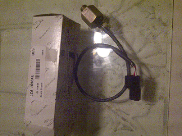

I think I may have purchased teh wrong knock sensoer for my 1998 xjr. See teh attached picture. These are not correct, right?

The "correct" knock sensor fits over a stud that is screwed into the engine. I **believe** that if that stud is backed out, the sensor you have will screw into the resulting hole. But also be sure the connectors are the same.

Thanks Boomer! The connector is the same which is why I am so confused with the other end. I don't want to make this project harder than it should be, but if it's simple enough to screw out the stud and this fits in there perfectly, then I can do that. BUt i want to be sure first.

I'm about 80 or 90% sure it will work. But see if it fits "hand tight" before torquing it down. Also be sure that there is clearance above the sensor - doesn't the plastic cover come down close? I'm not near any diagrams at the moment, so not sure. But I would try this before buying another one.

This is the knock sensor for the AJ26 engine.

@ gocallahan The 98' is fitted with an AJ26 engine, have you got to the knock sensor on your engine to replace it yet?
Have a look here at the knock sensors picture of a similar engine,
https://www.jaguarforums.com/forum/x...-thread-61113/
Post #5 has pictures of both the early sensor installed (the one you have) and later type.
Like Boomer says, it will fit, so no worries.
