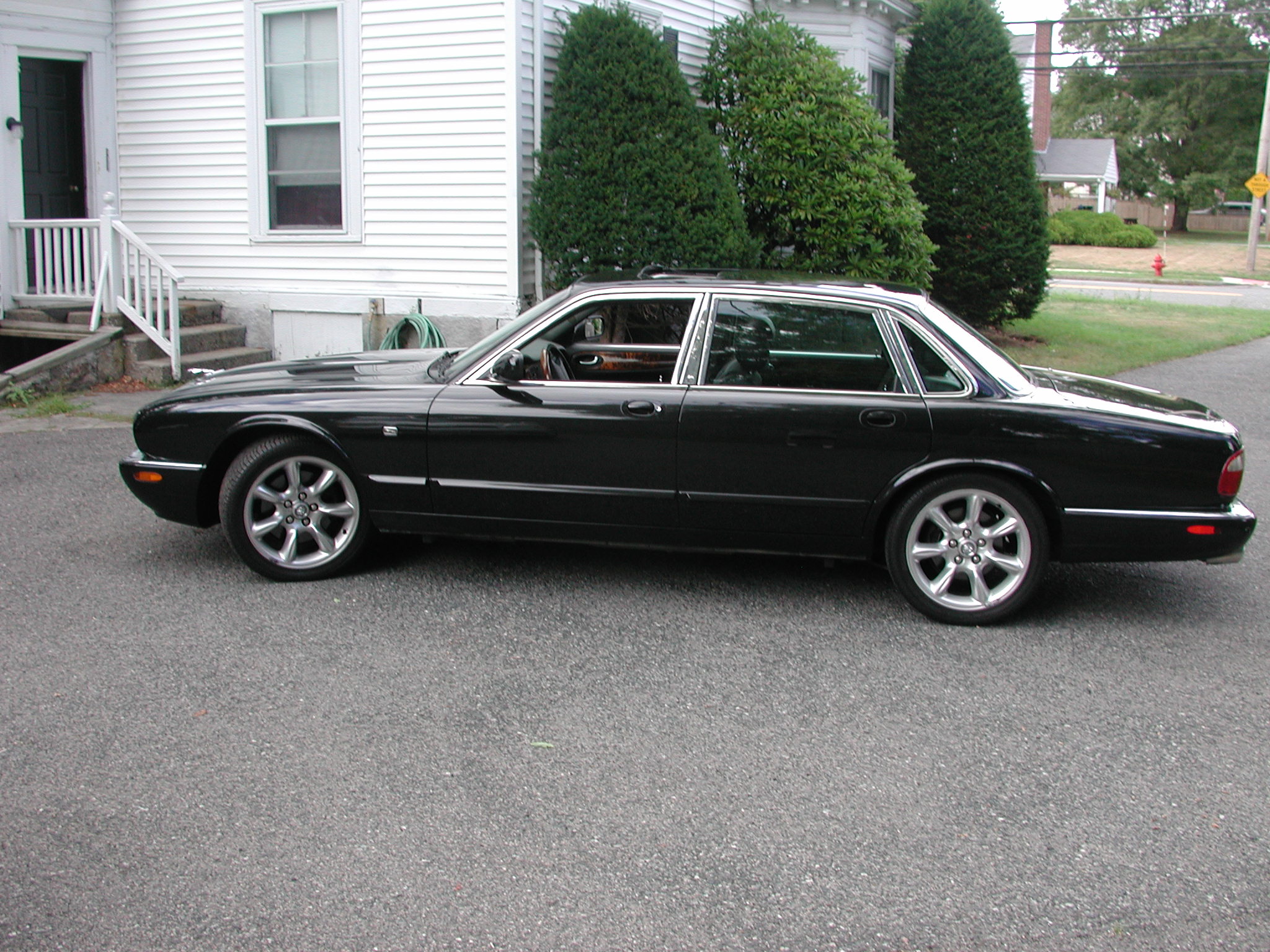

I experimented with sport mode last night and confirmed that all the comments on this thread are correct. Taking off in D with S mode on is totally different from with it off. I could see where it woud be quite useful if you wanted to blow away some kiddie in his hot Mustang at a stop light. Not me though. I drive like the old fart that I am and "baby" my Jag. Here's a couple of pics of what my wife named "Black Jack"
Attached Thumbnails How to use Sport mode ?-dscn2530.jpg   How to use Sport mode ?-dscn2533.jpg   How to use Sport mode ?-dscn2532.jpg
