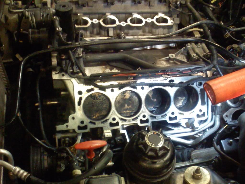

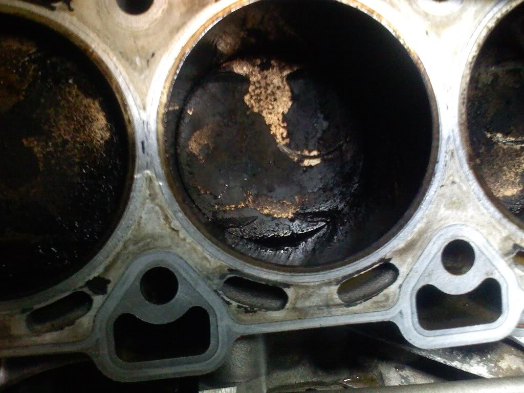

I am not real sure what happened to my engine as I bought the car at an auction with it damaged, it did run but was knocking slightly and missing badly. I pulled the plugs and did a compression test and found a couple dead cylinders, took the camshaft covers off and found evidence of some bent valves but the chains looked to be tight. I could see a couple of intake valves bent over towrds the sparkplug holes on a couple of cylinders. I am somewhat suspecting that the engine was overheated badly and may have dropped some valve seats but haven't got the heads off yet to be sure. The oil looked nasty, kinda red in color with a trace of watery oily sludge here and there. I talked with a local Jag mechanic and he advised me not to bother repairing this engine so I bought another wrecked 2001 for parts, hopefully the engine in it is good so I can maybe just update the upper tensioners and be done with it. I gotta be careful because with nearly ten grand in both cars now I am starting to get close to the price that would make this whole ordeal not worth it.
I think the brand new radiator and some signs of curb rash under the front suspension makes me think the radiator was knocked out and someone continued to drive it until it cookd the engine, somewhere I heard that the temp guages on these cars are not very reliable or am I wrong?

Every bit of that makes good sense, although I have not seen any overheated v8's with bent valves. Best verification was mentioned by FJT in another thread, which is to perform a cylinder leakdown test with the camshafts removed. Checking the valve clearancesfirst will usually reveal a problem, but it sounds like you already know you have a big one.
The XJ8/XK8temperature gauges are not responsive, many of these engines overheated from thermostat and waterpump impellor failures and the gauge stays at midpoint after the failure. The engine temperaturedoes not.
Your deduction about the radiator is logical: these radiators are not prone to any sort of failure unless they are damaged from rough driving or roughwrenching.

I don't know if maybe I was too quick to buy the second parts car but I guess it might be good to tear the engine down first and see what happened to make it bend the valves. I just wanted to keep my options open if I got into the position of needing another engine. The first car is a XJR with only 54K miles so I guess it would be kinda premature for it to have tensioner problems. The parts car whichis a rolled theft recovery has a few more miles on itbut I couldn't be real picky I suppose as XJR's are not exactly plentiful in the scrap yards around here.

I bought my 2001 VDP with a blown motor. The coolant leaked from the expansion tank and they kept driving it. It dropped two valve seats and blew both head gaskets. Due to the fact that if heads are damaged (they are normally repairable) you would have to remove the heads anyway. While you are there, you will have all the chains off along with the timing cover. At this point, definitly replace the primary and secondary chains and tensioners. Better doing it now and a very cost effective way to prevent future failures. I will post a pick here of the piston with the dents in it from the valves hitting it. Oh....also a very cost effective way to buy a Jaguar too btw. Worthless with a blown motor.
So FJT, if they overheat they are repairable.... I am maybe thinking I jumped the gun by purchasing the parts car now, how much did the gaskets, partsand machine workcost you to repair the engine? (I paid$2900 for the parts car)
