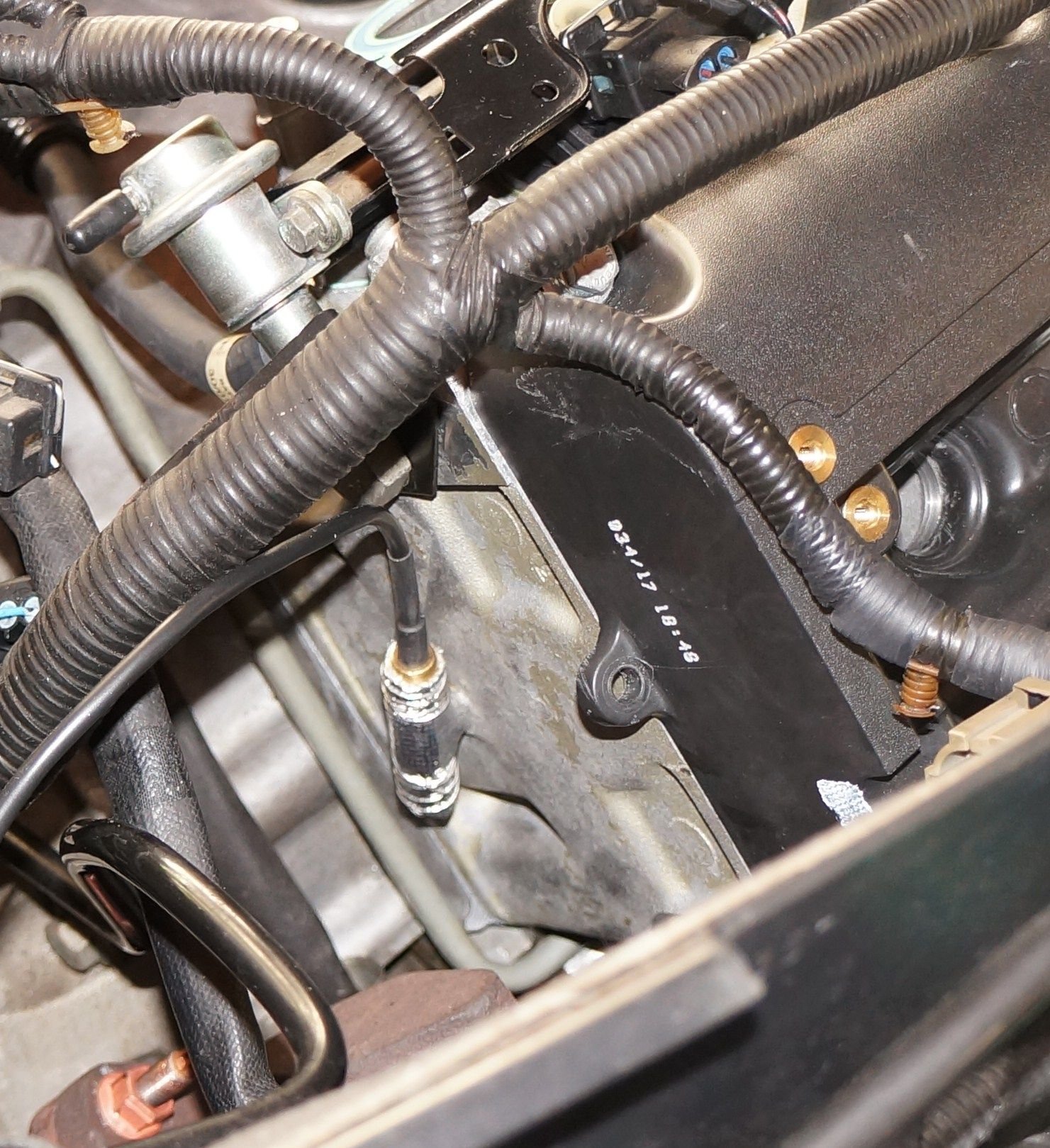

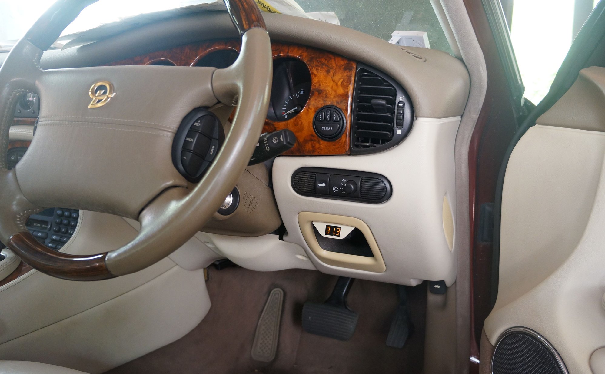

You can also install one permanently. My installation:
Temp Gauge (now replaced with one having a bit bigger display)
The probe (inserted into an adapter at the back of one head; not in contact with the coolant but actually sensing the cylinder head temperature)
