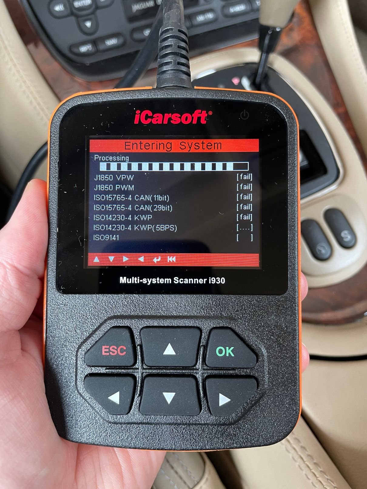

Recently went into restricted performance during normal driving a few days ago and also had a blinking CEL. The idle was very rough and reminded me of when one of the coil packs went out a year or two ago.
I purchased an iCarsoft i930 after reading some reviews here. It said specifically it would work for the X308 Jaguar.
Upon plugging it in, turning the key to the on position, and selecting OBD-2 Diagnose, this is what I see:
Thoughts? Seems like a nice reader but if it won't work with this car, I'll have to return it.
Also, when I started the car back up today, no CEL / no rough idle / no restricted performance. Weird...

yep reader looks nice but i had to return mine due to lack of compatibility, it has something to do with the software version, early works on earlier cars later does not, albeit mine was able to connect to ecu but was reporting unreadable data, so your case my be different.

You mention selecting "OBD2 diagnose" in your first post, which is not how I use it myself...
just select the first item (I'm not sure what the title is, but I think it's just "Diagnose"), which then allows your to select Jaguar or Land Rover ; then you select the year the car and you get another menu : "Automatic" or "Manual select".
Here I strongly recommend "Manual Select", which lets you enter each module (engine, trans, body...) individually and check the error codes and live data. The "automatic" will load ALL the freaking modules and it takes ages.
Mine works well, although yours seems to be a more recent version. However in my case, I can't get much information from the transmission module, or clearing the faults in the body processor, despite upgrading the software.

I've just bought one and it does exactly the same thing, despite saying Jaguar (1994 -2016) on the box.
As someone said, you can do a plain diagnose, but not sure whether anything important might be missing not having the ODBII diagnosis.

Did yours do a plain "Diagnose" as opposed to the "OBDII diagnose? Mine does but not sure whether it would read all the modules/clear codes that I would ever need if it can't communicate with the ECU, engine light for example.
I haven't done a software update, but the seller has asked me to, but not sure whether I want to if there's a chance that might even **** up the plain diagnose. I thought that it would be straightforward to buy a reasonable scanner, but it appears not!

Yes it did some stuff but i bought it for reading airbag codes and it gave some hex code instead of specifying obd code so i couldn't figure which part failed, i think it also did some strange things with fuel trims and some other undesired stuff, i don't think it gonna get worst with update and if it don't do its job it is already newer firmware, so maybe you could try seller suggestion as long as he gonna accept return if you change your mind later.

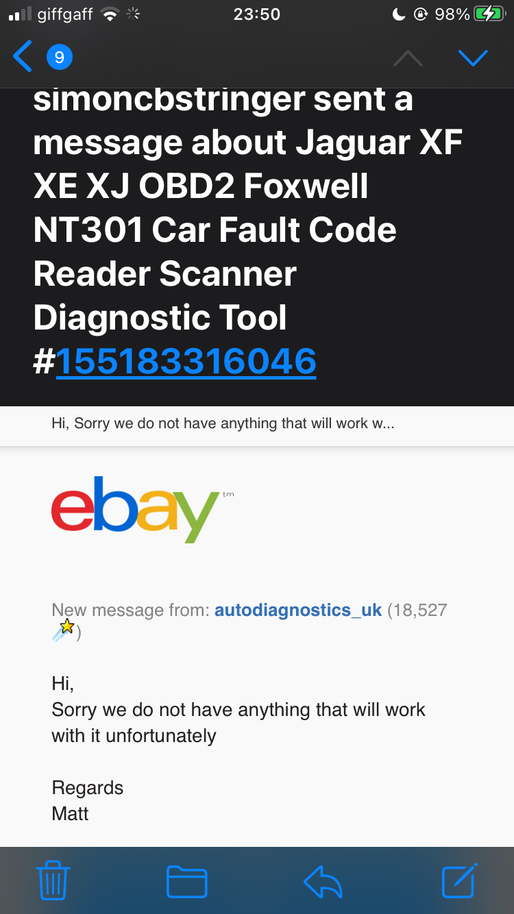

Jaguar XF XE XJ OBD2 Foxwell NT301 Car Fault Code Reader Scanner Diagnostic Tool | eBay
Is it compatible with my 1998 X308 though?
After a bad experience with the i930, with that saying it works on my car, but doesn't, I'm not sure I can trust whether it actually is!

Using a mirror, assure the pins in the OBD plug are straight and not bent; plug it in and go to position two (Accessory) in the ignition then follow the exact instructions to help it select the vehicle. Folks have had these work . . .

Yes it's compatible with our car I have one and it's working fine if you want something higher go with Nt644 elite I think 200$ on ebay take look on YouTube it has so many feature

i suspect Matt is not exactly informed about stuff he sells, but maybe things changed since then.

See the date of purchase I have this one and its working great That seller doesn't know what he's talking about
