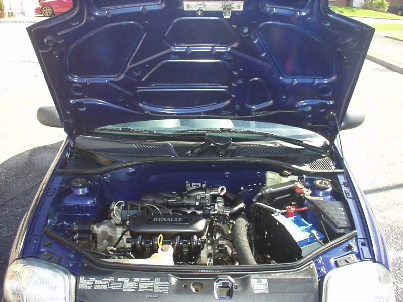

Here's the results on my sons Renault Clio...French car with decidedly dodgy electrics.
Simply used a spray bottle of APC solution and one of plain hot water....a few sprays with hot water followed by APC solution.
This then agitated with a rag or 1" paintbrush for tricky areas or hard to reach places, then dried with a clean damp microfibre.
Once finished this then a going over with "Wet n Black" or Aerospace 303 or similar buffed to a matt sheen.
Before
After
The results below are not perfect, but a simple 30 min method for cleaning a filthy engine bay.
Obviously take a little more care / time for even better results and NO starting / running issues afterwards either.....all good
