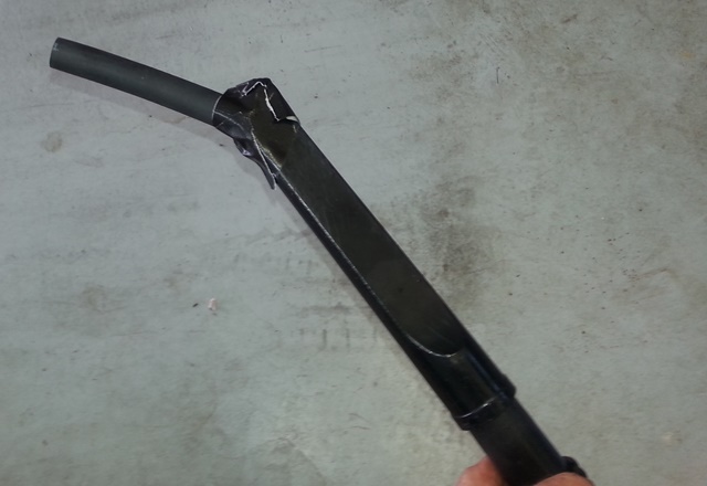

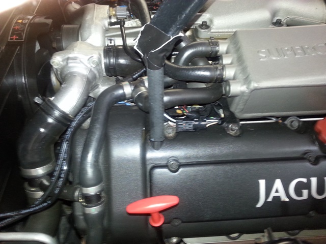

I read the instructions about cleaning the part load breather with a drill bit every time you change the oil and I have done so for all of my DIY oil changes.
There is a caution in the instructions to be careful and to not DROP THE DRILL BIT INTO THE CAM COVER!
Well, today I dropped it.
After I stopped screaming, which took a while, I started getting ready to pull the cam cover and retrieve the bit, hoping it had not fallen into the timing chain "grotto."
I noticed my shop vac sitting next to the car, I had vacuumed the interior while the car was running on the jack stands to check for oil leaks.
I thought, "Might as well try." So I taped a piece of 1/2" hose to the crevice tool of the vac, put it over the part load breather in the cam cover, said a short prayer, and turned the vacuum on.
IT WORKED! Sucked the drill bit right back out the hole! I couldn't believe my initial fumbling stupidity and luck with this one. LOL!
Vector
