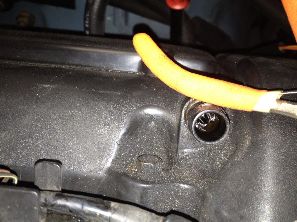

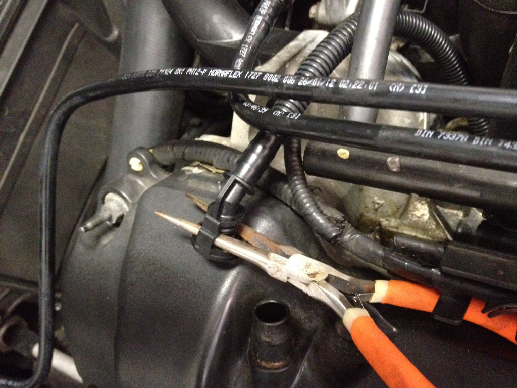

Ok, so I decided to check out my car -- first off, I couldn't find the tool to take off the PLB tube, so I improvised with a long, skinny needle nose pliers (see photo) that I could gently push into the slots and it easily popped the connector off. Next, I tried to take a photo of the inside where it might need to be cleaned (see second photo). It looked clean, but I wanted to jam something in there to see if it came out clean. I didn't have a 3/32 drill bit, so I used a 3/32 Allen wrench and the next one smaller. Didn't want to force it down too far, so I just wriggled it around a little, and very carefully, and it came out clean every time. So, I guess mine was cleaned by my mechanic when the tube was replaced, or for some reason I'm either not pushing in far enough or it just wasn't clogged. My idle is slightly rough, that's why I wanted to check it out.
