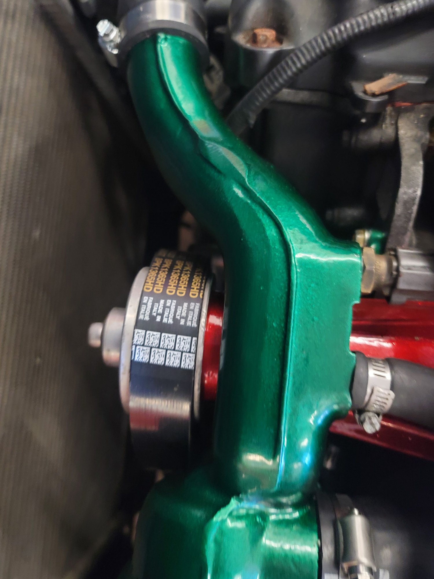

Starting to grind tonight. 2 hours later a lot more to go!
