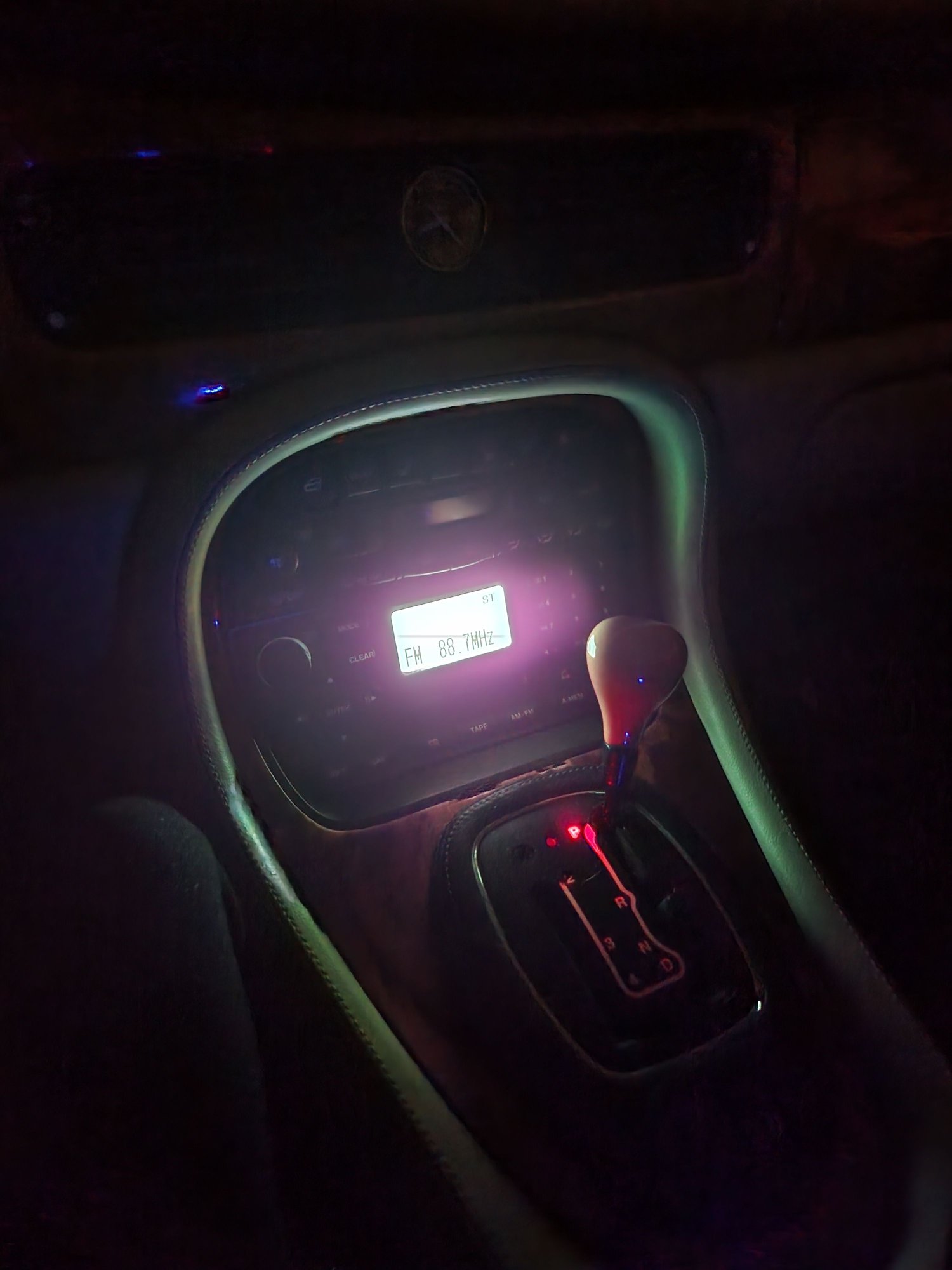

The Instrument Cluster lights are on, but the Dimmer Switch is off.
Regardless of the Dimmer Switches positon, the Console lights remain off.
This all started when I went to turn on my Fog lights one night, lights started flickering for a few days and finally went out.
