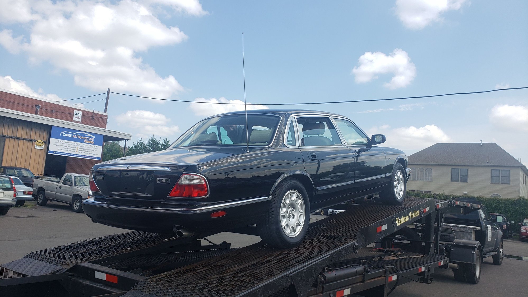

So I bought it sight unseen. After some negotiating, the car was loaded up and made the trip down from Pennsylvania.

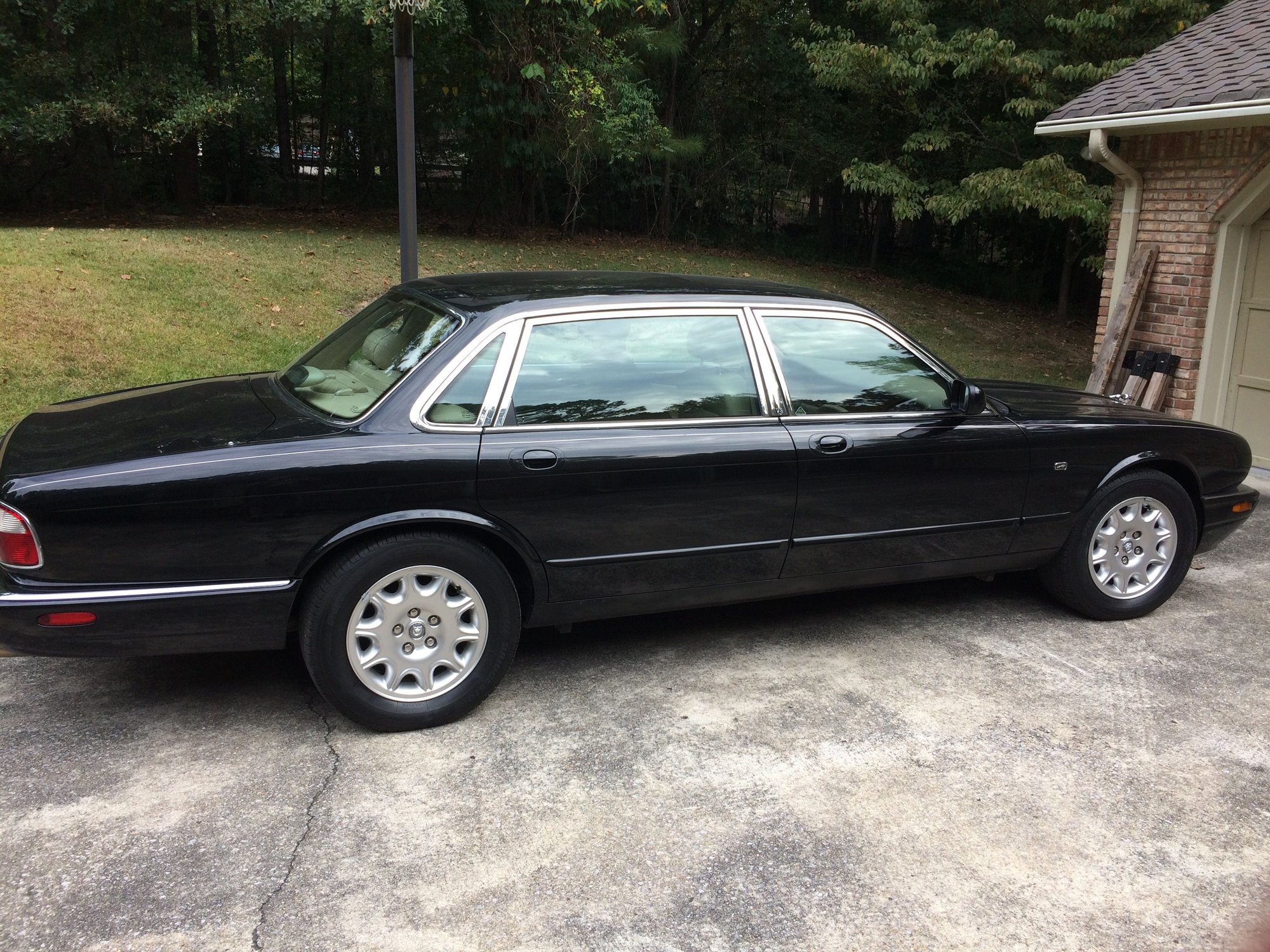

Here was the day it arrived back in Alabama.

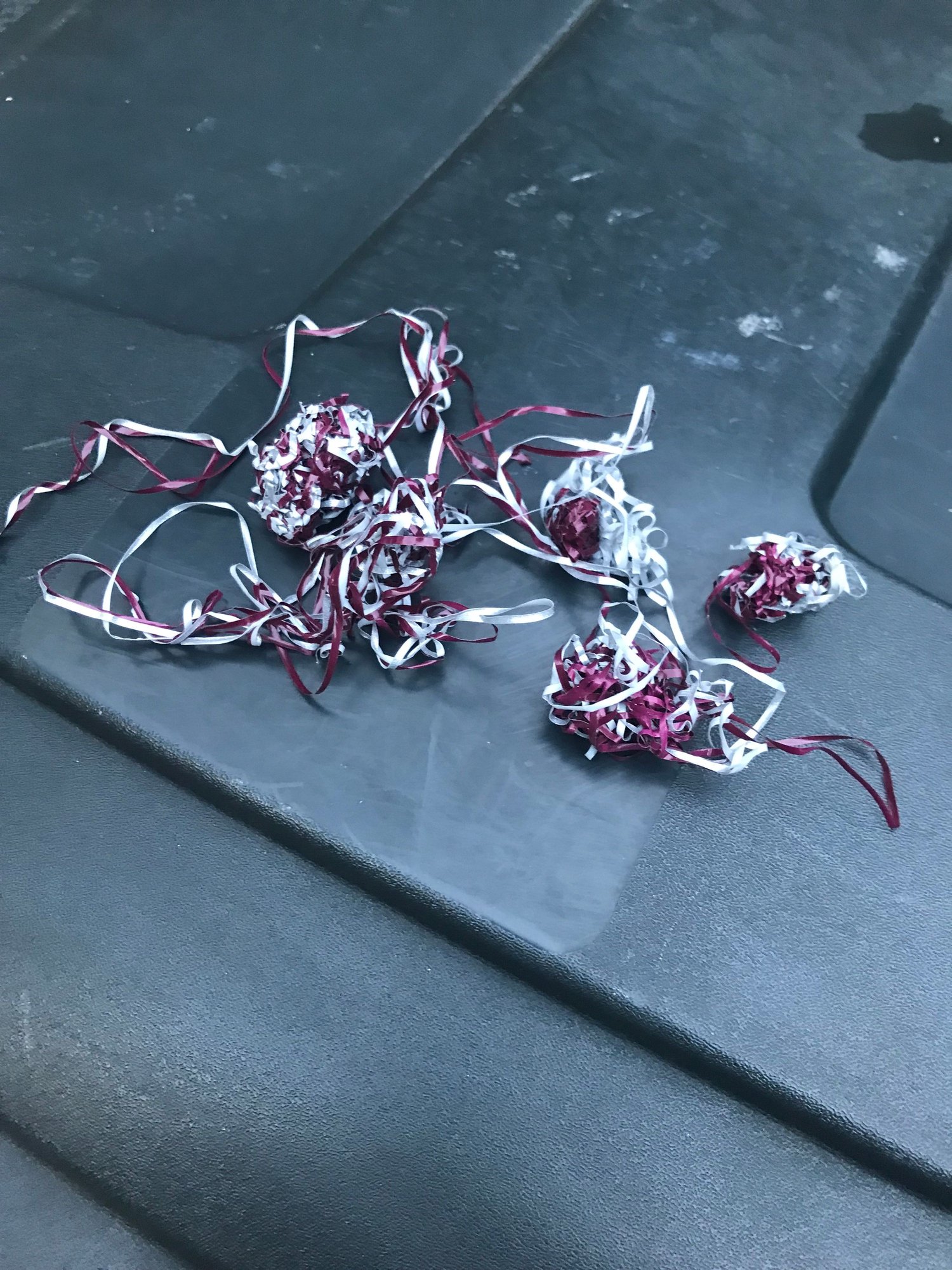

I was able to get my first good look at it. Overall it was pretty much what I expected, no big surprises. The first thing that had to go however was some hideous pin stripe that the second owner had installed.

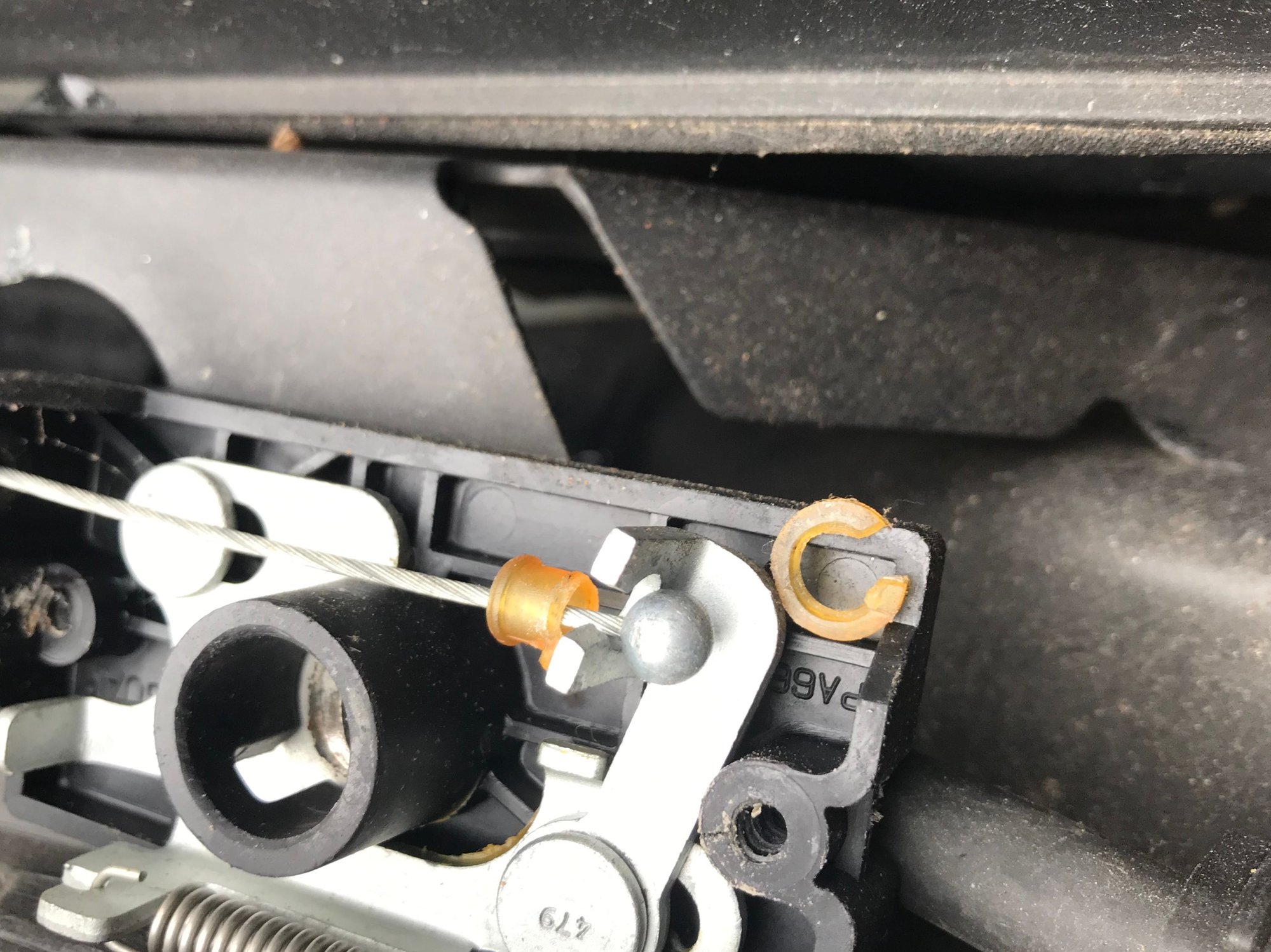

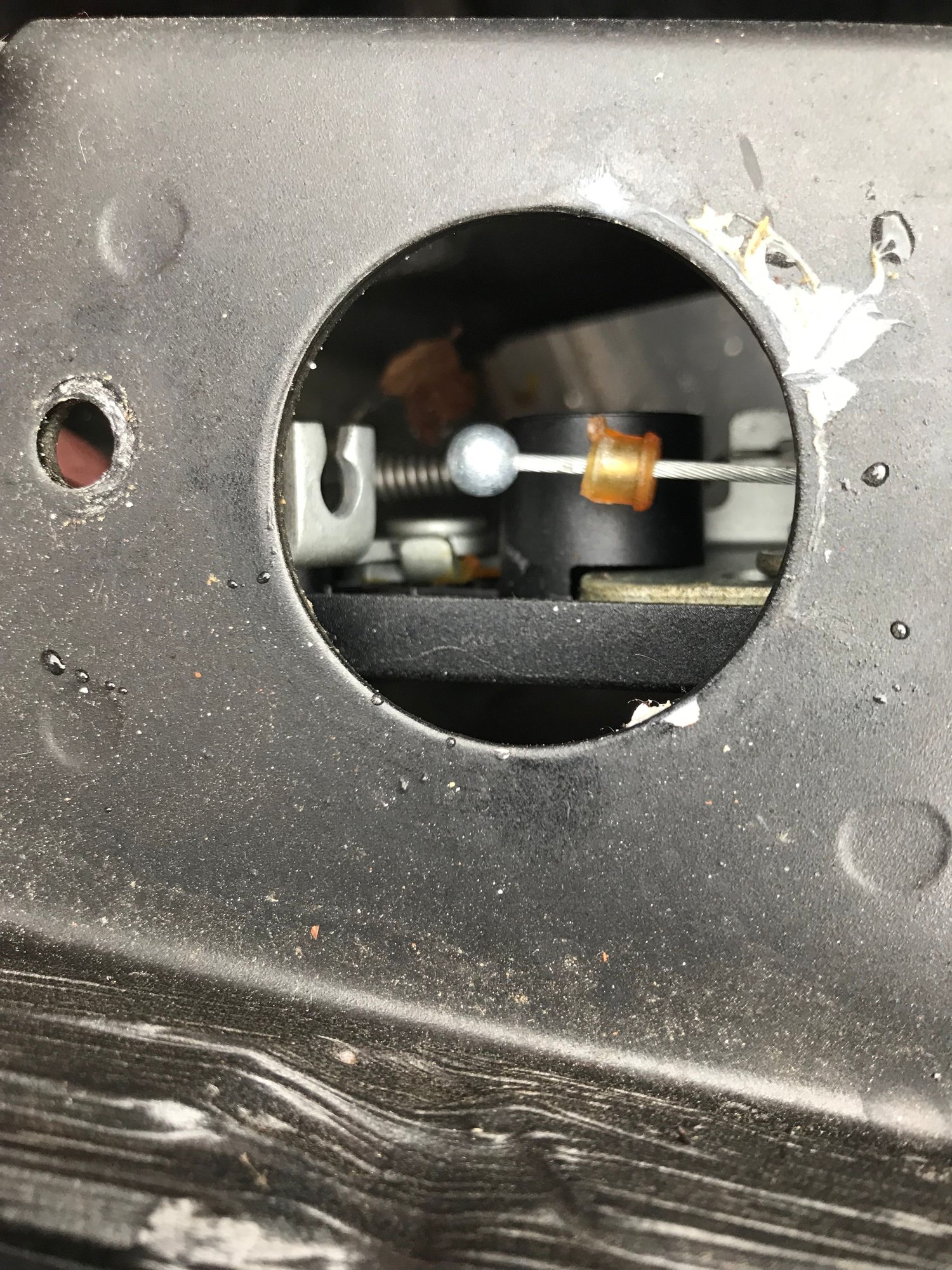

Then I found out that the hood latch can break lol.
So I broke out the drill on the driver's side wheel well and manually popped the latch (big shout out to the forums for the help)...then made sure that wouldn't happen again. Crimped the metal together for a permanent fix.

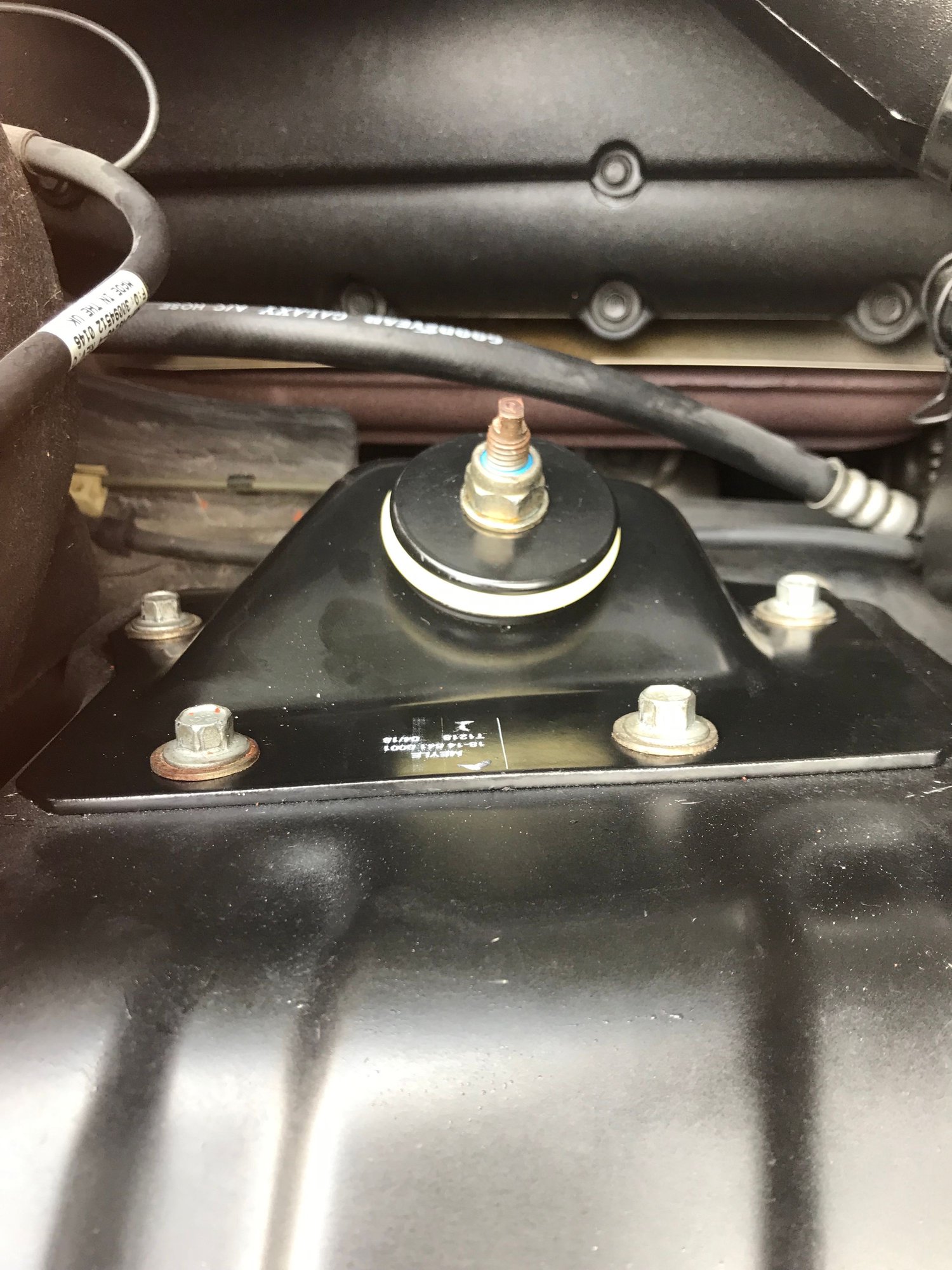

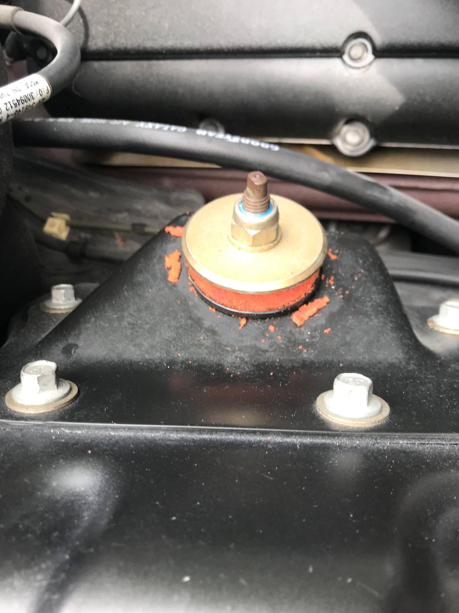

Then I ordered some new front shock mounts since the originals were shot and installed them.

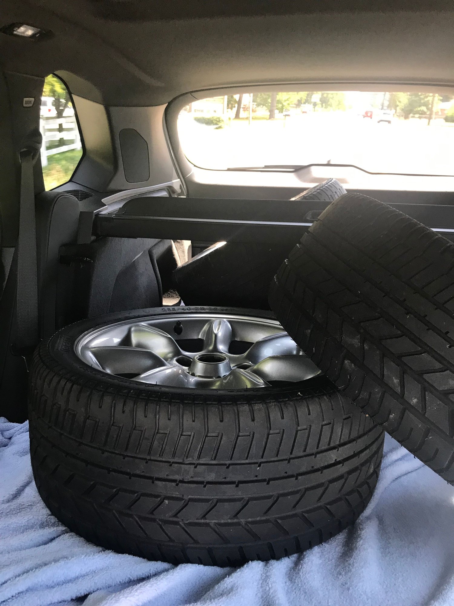

Then I scored a great deal on a set of XJR asteroids in Atlanta to put on later, but wanted to make sure the car looked all original when I gave it to my dad. I had some new Potenza S-04's installed later.

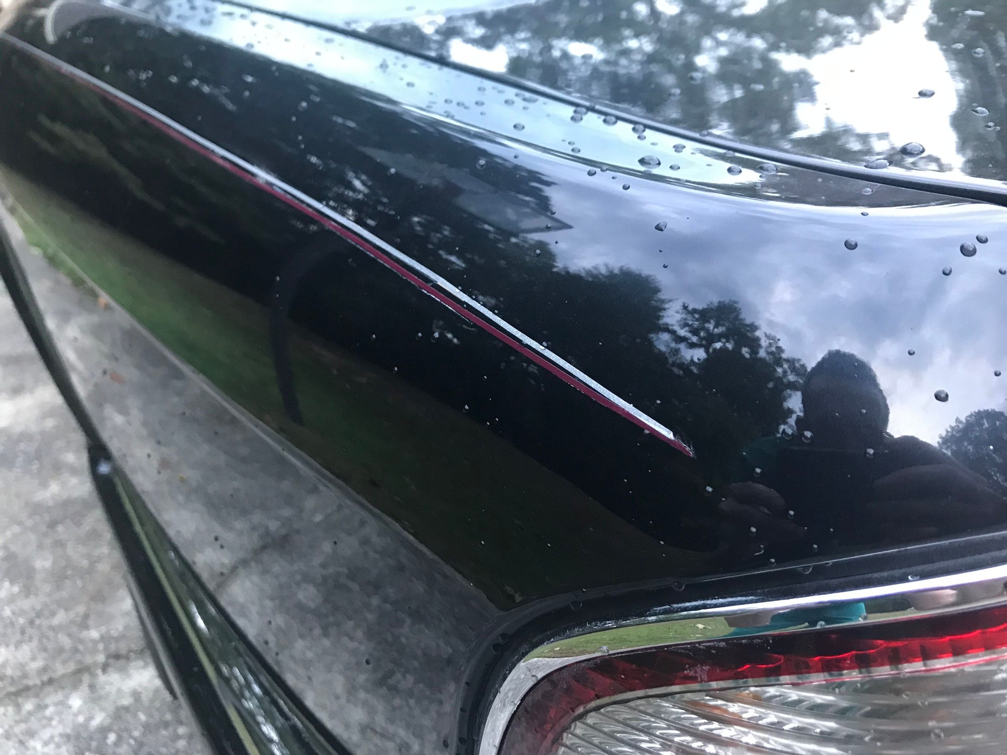

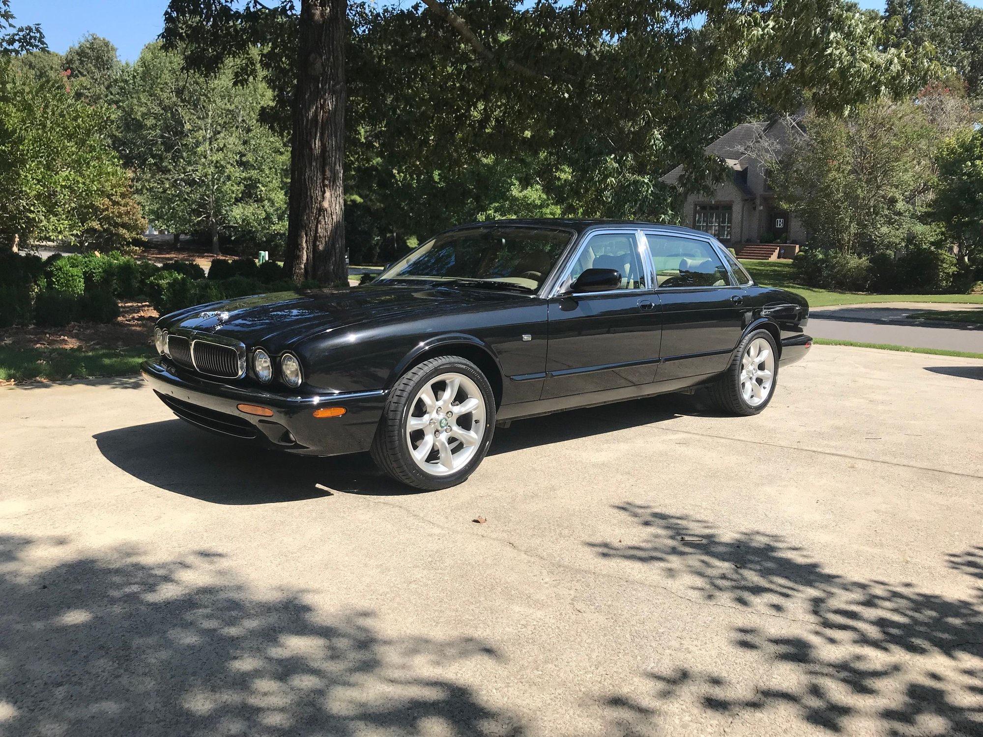

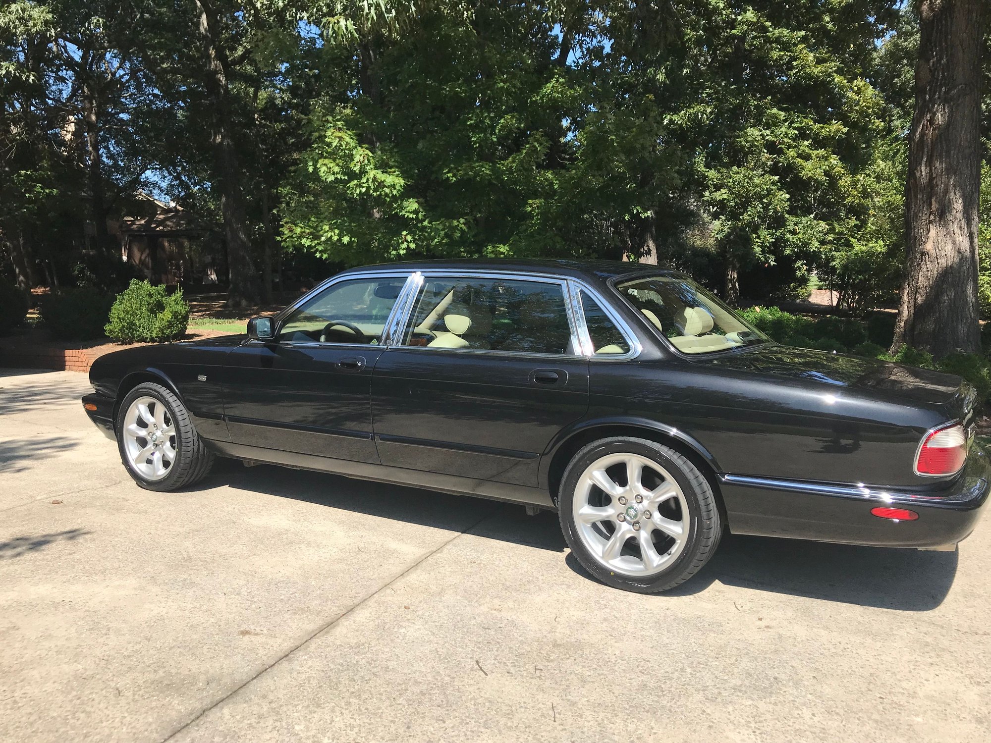

After handing over the keys, I decided to throw on the XJR wheels and give the car a proper detail. The previous owner or the dealer attempted a detail however there were holograms and swirls all over the car which needed correction. Here is a pic which sort of shows the swirls
I used a Porter Cable 7424 random orbital for the detail. Washed, clayed, swirl removal, polished, and waxed the car. Took about 2 days to get it right. Here are a few pics afterwards.

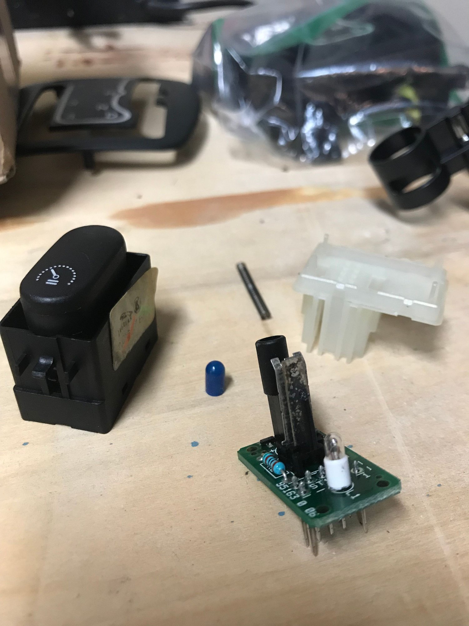

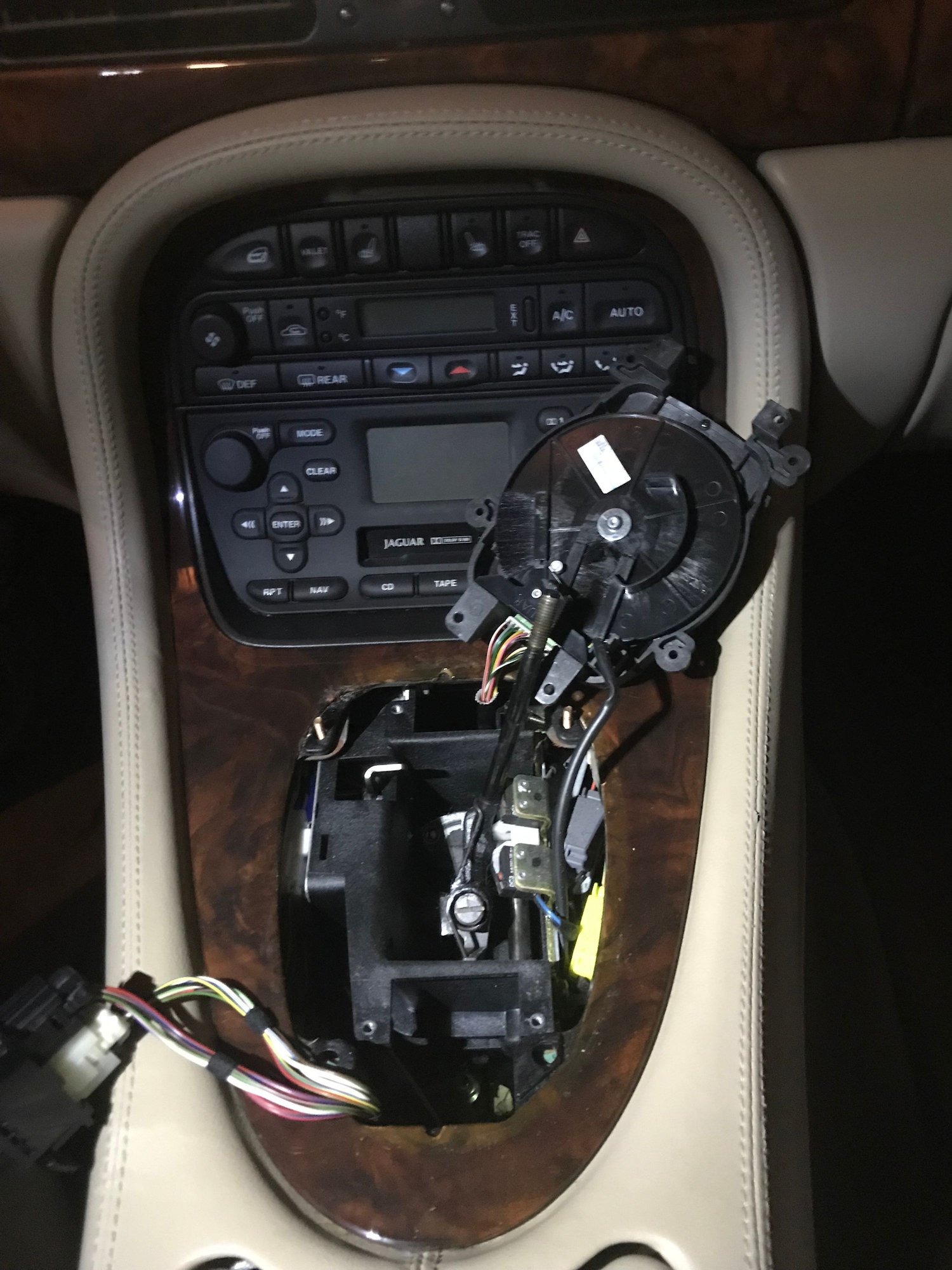

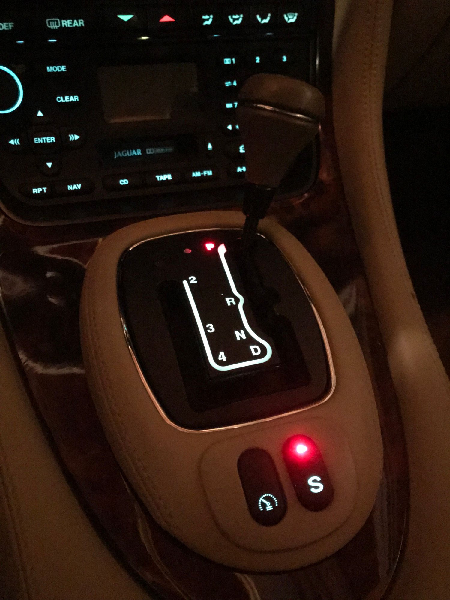

I also recently replaced the J-gate trim and also fixed several old burned bulbs around the selector and cruise button

Graham, love the look of your factory stripe. It fits the car very well. I just had to get rid of the stuff the PO attempted. Not only did I not like the colors, but the raised borders collected all sorts of old wax and cleaners. The porter cable really cleaned up the old reside and markings. And you're right, we saved the Jag from the harsh road conditions before it could see winter weather. I've lived in the Northern US before and it's pretty unforgiving on the cars!
