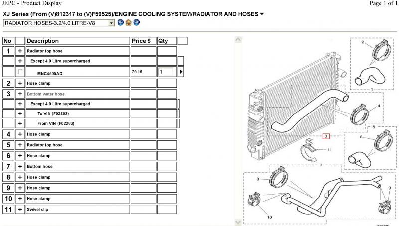

There's not much room to work in these, is there? I've got to do without a jack, so I'm looking for a short cut with draining the radiator (can't get to the plug very well without a jack). Someone mentioned removing the lower radiator hose, so I might go that route. Although I'm not entirely sure which hose is the lower radiator hose--it might be the one with the metal fixture on it, I guess, but I hate to rip into it and be wrong. Advice?

Old Jul 25, 2011 | 03:30 PM
jimlombardi's Avatar
Posts: 2,636
Likes: 1,636
From: Southington CT
Hi
Here is a diagram from the JEPC (Jaguar Electronic Parts Catalog)
Just Purchased--and Overheating!-xj8-bottom-radiator-hose-parts-list-diagram.jpg
