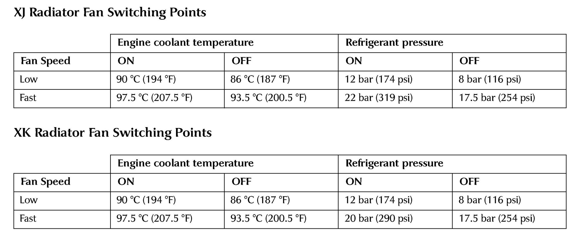

No separate sensor/switch for the fans,they are controlled by the ECM based on the coolant temperature. The ECM switches the special triple relay module (low down at the front left corner of the engine compartment) which engages the fans in low or high speeds. According to the service manual, the switching points are:
I would first check the fan fuses and, if good, the fans themselves by connection to an external battery.

Well, ignore my info, OP. Seems I got the numbers wrong!
