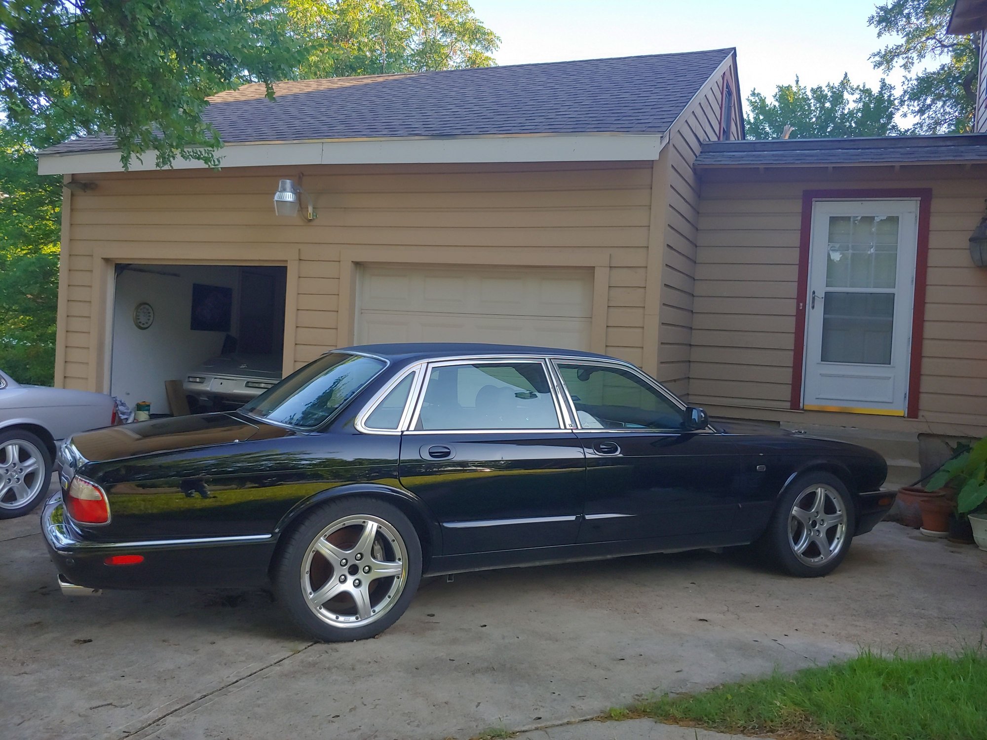

Still have it. Here she is. Been kinda iffy on selling it cause I'm kinda tempted to pull the heads myself.
